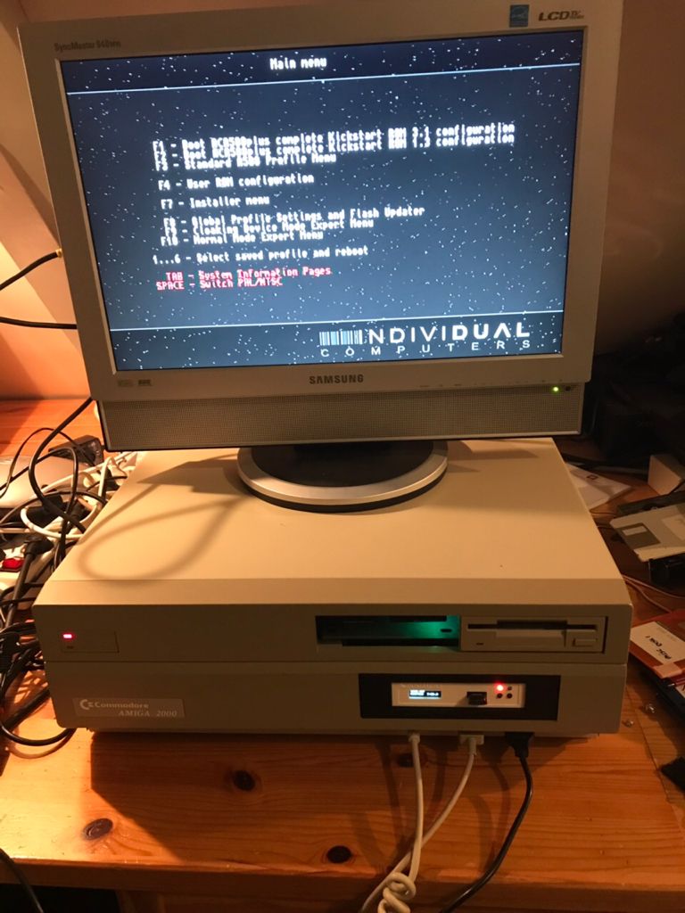

Hi, my Feedback... on my 4.4 A2k was only viewing the green error screen of te aca500+. On my 6.3 A2k it is running, booting but generally not running really stable.
Big memory actions, e.g. after quitting software is running into complete stopped system.
I'll try to test it with shorter cables because I think they are really problematic unbuffered making the bus so long.
But generally, it works. ;)

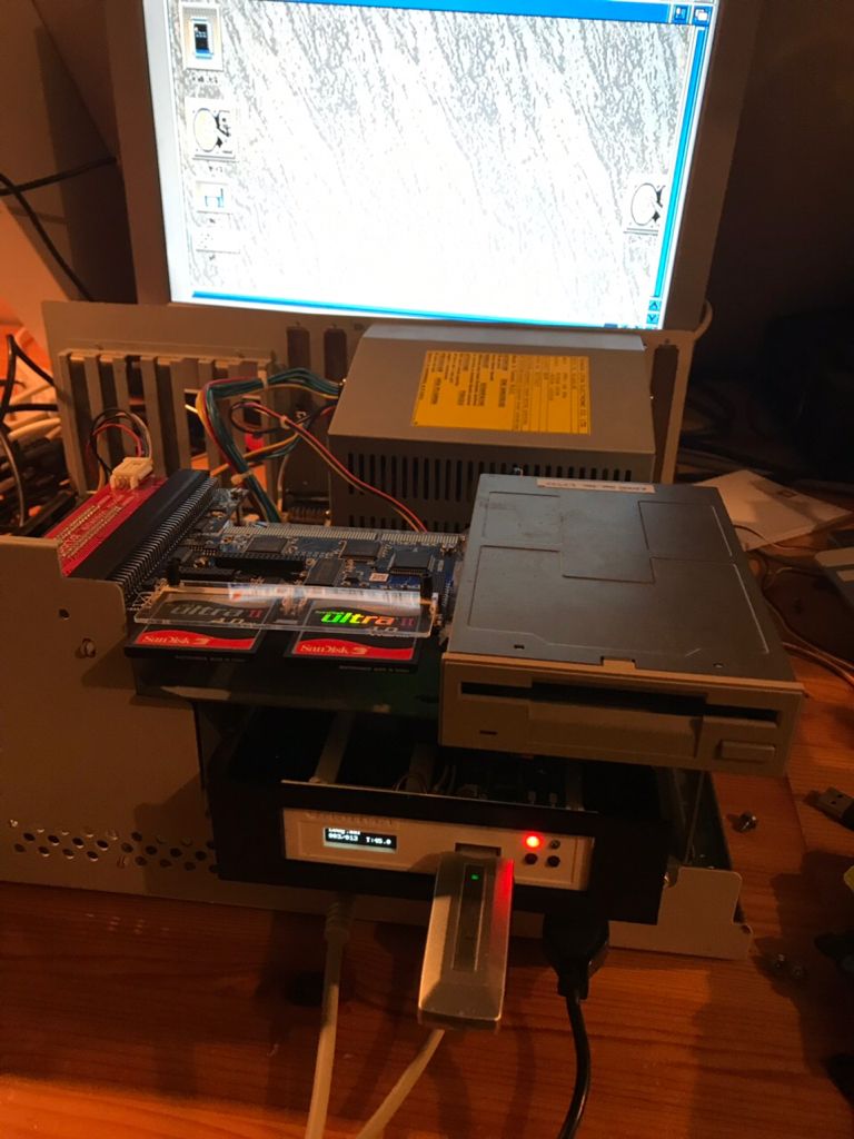

Here some pictures of my setup now. Gotek drive now as df0:
Diskdrive as df1:
Working stable.
But not above 21 Mhz.
21 Mhz no problem.
No other zorro cards installed.
