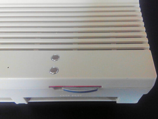

Having sussed the SD2IEC interface I bought by plugging it in with the provided connectors I wanted something neater, something hacky. In short I wanted to apply Dremmel, sandpaper, solder, and hot glue, to make it neater and make it mine.

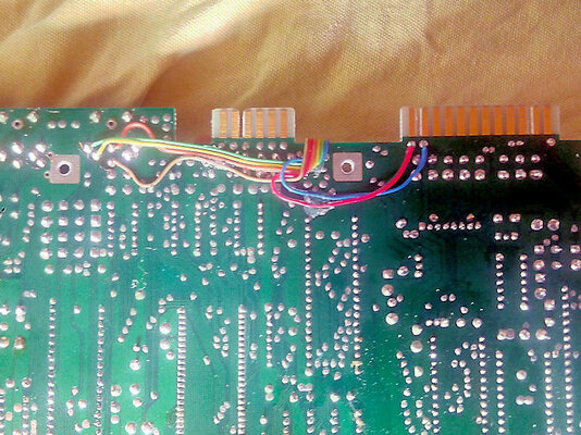

First I buzzed out the connections while it was all set up, decided where I wanted the interface to be mounted, and then hacked the multicoloured ribbon cable to length before soldering it to some likely points - Note: actually bothering to read up on the subject is for people who aren't in a hurry!
After testing to see if it still worked (yes!) I desoldered the two tact-switches for 'disk change' and 'reset' from the SD2IEC board and mounted some taller ones to the opposite side - the eagle-eyed will have already spotted the plan.
I generally can't be bothered to measure stuff (you should). So by eye I cut and sanded the excess PCB from the SD2IEC board so the SD slot would be flush with the end. I then Dremmeled and sanded a slot in the lip of the upper case so then glued under it the end of the SD card would be just poking out - a cheeky little mini MicroSD adapter suits nicely I feel.
The plan for the buttons was to use a couple of nice silver tact-switch caps to poke through the case for a sympathetic look. The reason for using longer switches was I'd learned my lesson from doing a similar mod for my Atari 800XL - lots of very fine and frustrating Dremmeling, then Supergluing, to make some bespoke switch tops to work with the supplied ones.
At this point I did actually get out a pencil to mark the switch positions then started to 'drill' two holes with the end of a pointed hand file... Why?
While the C64c PCB is nicely made the case is made of very cheap plastic akin to soft cheese. (Atari 800XL is the exact opposite in both respects) I wanted to take it easy for a good result and twisting a hand file was all that was required to go through the plastic!
I then fettled the holes with a screwdriver wrapped in wet 'n dry, and also sanded the inside of the case to get both buttons to stand as I wanted. Then placed the PCB over the top, checked everything worked, and hot glued it in place. "Oh how I love thee, hot glue. But why, oh why, do you burn my fingers so? And why must your gun always do that infuriating dribbly thing?"
Next I offered the lid + SD2IEC up to the base to work out where and how much to Dremmel and sand form that... At which point I found the weird metallic paper that passes for an IR shield in this machine was in the way of the connector - never mind, every cloud: Scissors cut paper. Ah, AND a cap on the PCB was in the way - 'bendy, bendy' and the cap was 'relocated'
All still working? "Yes!"
A result.

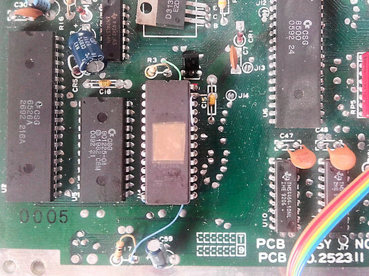

-Replace CBM ROM with EPROM-

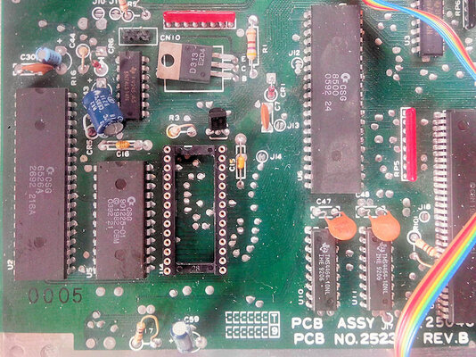

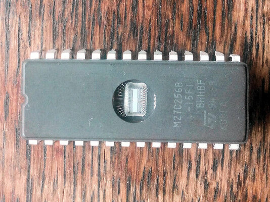

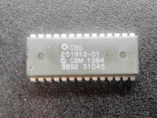

In my case my machine has a 'short board' that combines the 8k kernal with the 8k basic. So if I want to switch between CBM and JiffyDOS mode I need a 32k EPROM to hold: Basic+Kernal+Basic+JiffyDOS. I then need a way to switch between '16k banks' depending on what I want to use.
The ROM is easy enough, even for us 'doze users. Assemble your ROM images in a folder, open a command prompt and issue something like the following command:
copy /b Basic.bin+Kernal.bin+Basic.bin+JiffyDOS.bin 27C256_JiffyDOS.bin
One will then have a suitable image to burn to ROM, in this a 27C256 although a 27512 will be fine - just use the above command to put two 27C256 images together.

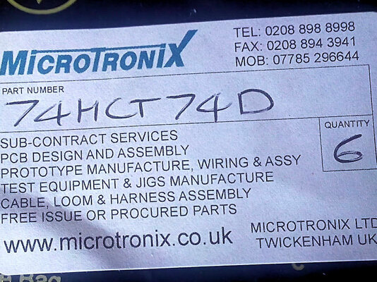

-How to Make a Switchless Dead Bug-
In a nutshell it's then 'just' a case of plugging in your new ROM in having lifted pin 27 as that will need attaching to some kind of switch to choose between 16k banks. As you will see from the above pictures I did something a bit more sneaky. With the aid of a 74HC74 and holding down the <Restore> key (or not!) on power up I can select my 'OS' without any messy extra switches. The scheme I've gone for is a variation of the idea I found on Pasi Lassila's Blog. I'd say his implementation is less fiddly and, um, 'ghetto'. Mine is less obtrusive when installed and I can more easily pull and reprogram the EPROM should I want to.
-CBM ROM Out, Socket In, Switchless ROM In-
I happen to prefer turned pin sockets to the wipe type. One will see I removed the center bar from the socket to ensure room for the 74HC74 under the EPROM. Two further slivers of Kynar make the final connections to allow the 'switchless magic to happen. Pin 27 isn't removed, just decorously dangling out of the socket like... so much well turned leg and thigh peeking from under soft Egyptian cotton bed sheets. Ah, um. Moving on...

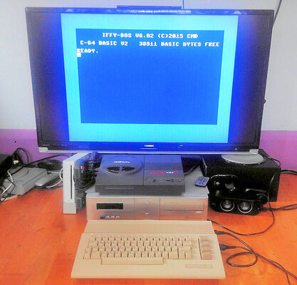

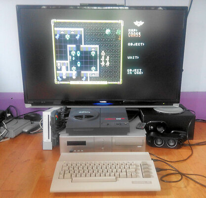

Last piccies of my baby in action:
-IFFY-DOS, CBM, and Playing Laser Squad-
All working well with JiffyDOS - I couldn't resist a little hackery before I burned the ROM. (The colours aren't quite true in the photos, rubbish camera) Oh, what a pleasant difference it makes! <Power On>+<Restore> and I have boggo CBM should I ever need it...
...I've always said "The measure of a good 8bit computer is how well does it play Laser Squad?". Actually I pretty sure that's the first time I said it, especially as neither Beeb nor Atari have a version I'm aware of... but the C64 plays a darn good game, if just pipped by the CPC version for top honors.
