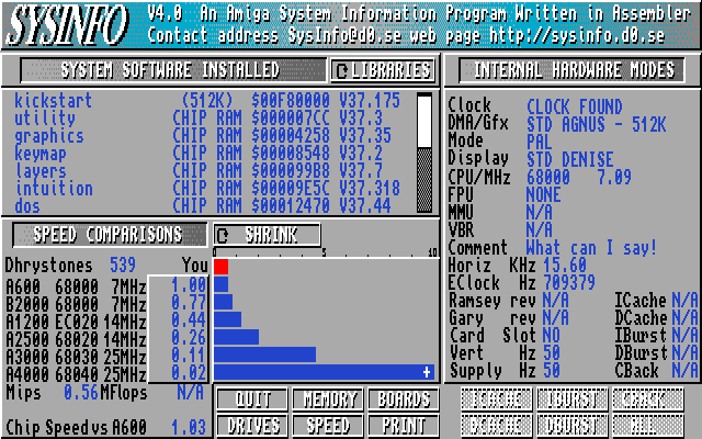

but for your expansion - you are right, it seems that the starboard is not being configured ... can you use SysInfo or some similar programm to find out whether it shows up in the Expansion-list or not?

no.. neither on extras nor on the workbench there is any tool to show expansions (boards).
sysinfo can be found here (it gives you a lot of information on your system .. like CPU, speed, memory, loaded libraries, attached boards.. etc)
https://sysinfo.d0.se/
-> download of lha and ADF-Diskimage.
