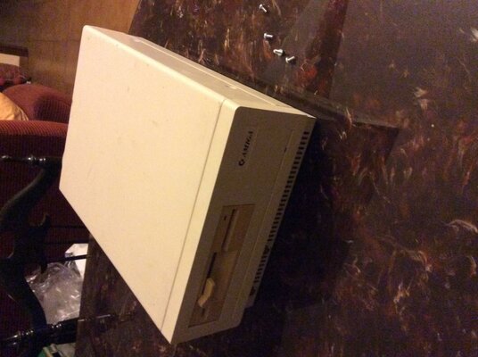

Hi,
i would like to share my progress with this hardware.
My objective is pump little bit this board and configure with a bootable PC Hard Disk.

I own the rev 3 version and it comes with a 5,25 Chinon PC floppy, 256Kb Ram (for PC) and an 8088 CPU processor at 4,77 MHz.

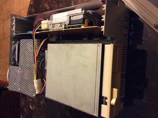

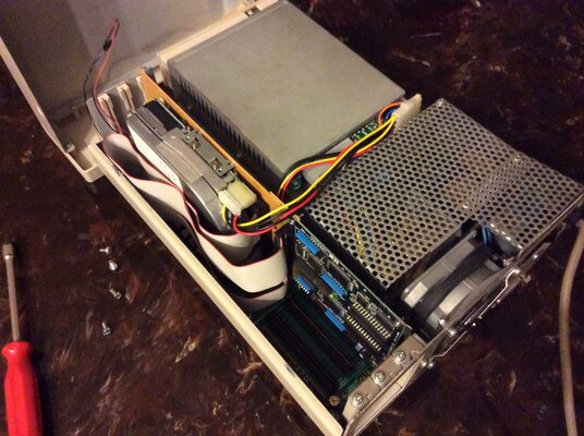

My hard work is to find one of the last MFM HD version, released in 3,5 inches format (instead of old 5,25 format). When i found this 3.5" MFM HD i plug it into an old IBM and i start to initialize and configure properly a DOS environment. After that i found an 8 bit ISA HD controller and i plug into A1060 isa for check compatibility with Amiga hardware and MFM Hard Disk. It worked perfectly! So last step was to build an ISA HD controller extension for HD place. So, as the A2091 or GVP HC +8 SCSI controller have the hard disk place in the second part of board, i did the same with my ISA HD controller.
Result was to keep controller and HD in the same line of the first A1060's 8 bit ISA slot.
I can close perfectly my A1060 with its original floppy driver in the original place.
Inside Hard disk works good :-)

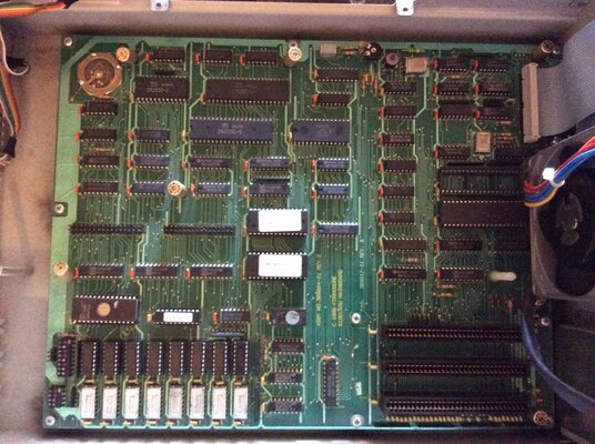

If i well remember, A1060 has a native 3,5 floppy controller, i need only to place a cable. (you can see main board picture, there are two floppy pin connectors).

I don't think it supports 3,5" drives (as I think a real PC XT wouldn't, either). I'd like to be proven wrong, though :) There is only one floppy connector, the two on the center of the main board go to the daughter-board.

I saw two A1060 motherboard versions. One of these has a switch configuration for RAM setup. So if you add extra RAM you need to modify the switch configuration. My board revision hasn't the switch RAM. My revision is auto-sense RAM.
We are right 50% each other :-)
One pin connector is for the daughter board. But 5,25" floppy controller is in the daughter board with the old two gray bus cable. (one for bus and one for power)
The second pin connector is the 3,5 floppy controller. ;)
