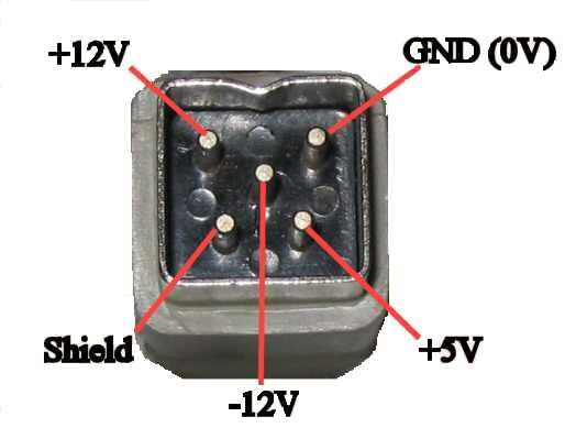

@ Zetr0 states, the colours might vary, however, the pinouts at the plug end are these;-
1. +5v
2. Shield Ground
3. +12v
4. Signal Ground
5. -12v
The pins on the plug may be numbered, you should be able to buzz out the wires from the pins on the plug.
The pictures attached might also help you.
