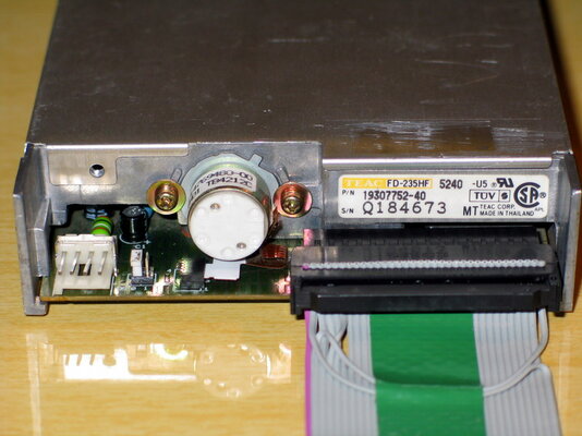

Are you able to get some pictures up?
I am currently working on a few PC configged Teac's. Some have no jumpers at all and can only be modded by soldering and using jumper wire.
EDIT: On the back! Where the floppy pins are, there should be a sticker. Where is reads "FD-235HF 4161" there should be another long code printed. If the label is not on the back, it will be on the top lid. I am wondering now... did you recently acquire this a1200? It could be a mashup of parts...

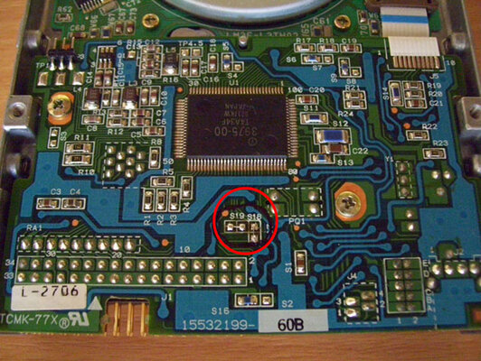

The board came with the shields, floppy drive and the floppy cable too. What I see in WB is df0?????? Oh this floppy board is the same as in my drive, and in the red circle those jumpers are closed. (Mine is using 0HM resisters instead of a wire)..

Ok this looks like one of the infamous Teac drives I have here! Where the large spindle/silver disc is (towards the front) is there a large blue rectangle thing soldered to the board with a small tiny smt capacitor? I think you have a proper A1200 Teac and I am leaning towards a failed cap as the cause of this drive not working :) Fairly simple to fix.
Edit2: Some sparse info for this drive! Your picture shows me there are a row of small jumper blocks sitting near the power plug! Same sorta thing you get on hard drives but a little smaller and usually white in colour.
On this link look for "FD-235HF-4xxx TEAC drives", there will be a small picture shown with it and a diagram of the jumpers. If yours looks the same then it is a proper a1200 drive: http://embeddedsw.net/EMUFDD_TEAC_Jumpers.html
Edit3: This is what your looking for - https://www.amibay.com/attachment.php?attachmentid=66919
Yes I see the small SMD CAP. Also what your saying the drive is a still proper a1200 drive (Escom 1200 one) Oh as for the jumper (with the white plug) The first pic is mine (Just 2 headers)...

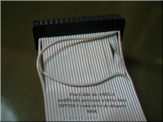

Oh Here's a pic of a cable that was made also (For the FD-235HF)
Mike..

Oh Here's a pic of a cable that was made also (For the FD-235HF-4161)
