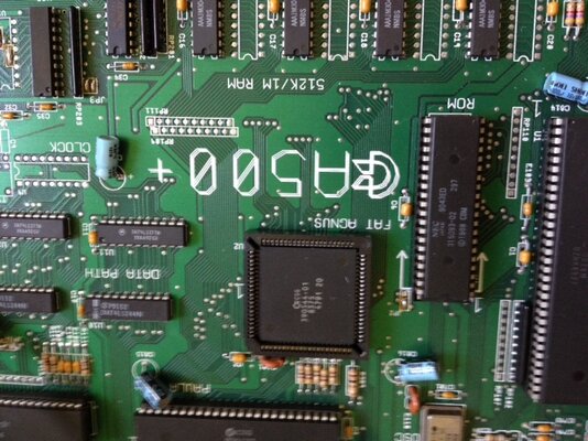

IMG_0326.JPGthanks guys for information :)
just one question about agnus
I have Amiga 500+ 8a.1 motherboard and there is agnus 8375 look photo
handle this agnus 2 mb chip in my A 2000 rev 6.3 ? when I will make this mod ?
sorry for low quality
Agnus 8375 - 390544-01
4791 20

yes it is,but im sure its a different pinout to the one on the 2000 motherboard hence the need for the adapter.

i could be wrong,but its better to wait for others to confirm it as well.
like i said,its been a really long time for me.

Roy is correct. The only members of the 8375 Agnus family that are pinout-compatible with the A2000 are the 1 MB Vbb versions 318069-16 and -17.
Even then some rework is usually needed.
If you want 2 MB chip RAM on the A2000, you need to either use a Megachip or do the hack with the 8372B/8372AB Agnus. It can be done on rev4.x motherboards as well but needs extra DIY rework.
