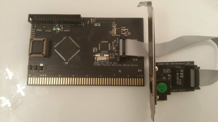

Just want to let You know about Zorro LAN IDE Card designed by Matze:
LAN part works nice with Miami, Genesis or Roadshow, (makes 3.5MB/s in Zorroll, & 6-7MB/s in Zorrolll mode)
IDE part uses Oktagon/Oktapussy Bootrom, so it can autoboot,
The clockport is compatible to A600/A1200 ones but resides at a different address
Have one card for sale, but I'm afraid shipping to US will be too expensive.. ??‍♂️
Thanks for the lead. Do you consider the project to be stable? Has the card performed well?
Well, it took some time this card was debugged, now i can say - it performs very well, it got a combo Firmware for Zorroll/Zorrolll, so it can be installed in A2000 or A3k/A4k now without need to reprogram it.
Have two cards, one is installed in my pimped A2000 together with "Dicke Olga" 128mb accelerator and Delfina Audio card. Im listening internet radio usually on that machine. Other one is plugged in my A4000, that one isn't used much..?
The project is missing a BOM/parts list. Do you have a copy of that or did you buy the card already built?
You can extract Partlist from Eagle,
Also be warned thast ENC Chips from chinese suppliers will possibly not work,
have bought some on Aliexpress and eBay - these doesn't seem to work - have no MAC address programmed,
seems these was stolen from factory before final step was done... ;)
