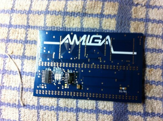

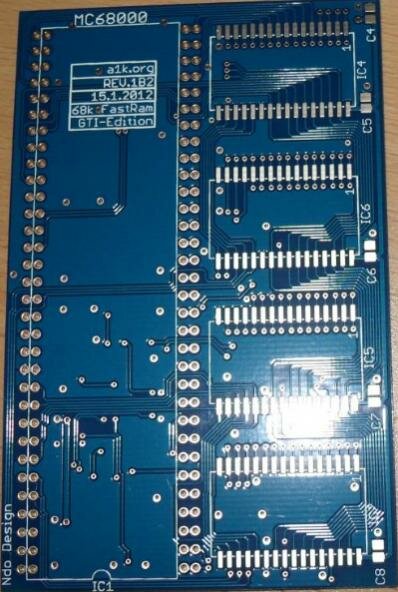

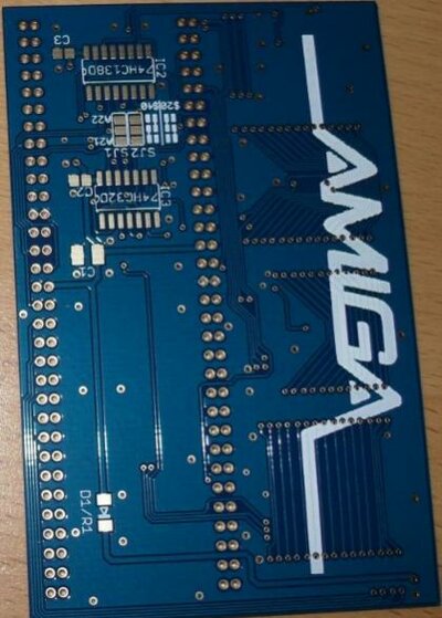

AmigaGTI has (eventually :-) ) sent my amiga ram kit for the A500 and the xmas holidays have given me the ideal time to build it even though im not at home over the xmas holls.
The kit arrived just before xmas and contains all the parts needed and i have to say the parts are very good quality and the PCB is excellent.
Documentation is pretty good and the german to english is pretty good too.

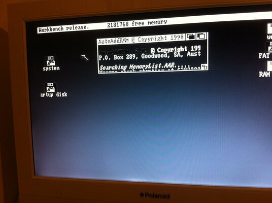

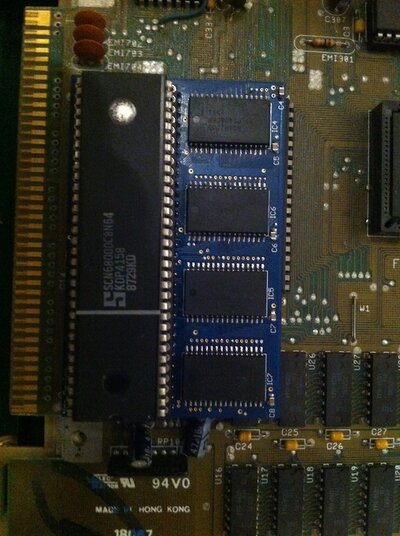

anyway here are the pics and my A500 1.3 with 2mb ram free.
I have an IDE CF adaptor too so i though i would see if they work together and in deed they do :-)
Over all it took me probably an hour and apart from putting a cap in the wrong place (oooopppps) the build went perfectly.
ram is addressed at $2000 and adds 2MB at start up. (non autoconfig) The best A500 is a 500 plus really as it has 2mb chip ram
So overall a really well made bit of kit - AmigaGTI ( he doesnt seem to be on Amibay much but he can be reached via his web site if people are still waiting)
mike

Is there no way of adding more memory
Sent from my Nexus 7 using Tapatalk HD
Possibly by changing the ram chips 4x512 at the moment.
Now mike are you going to try it
