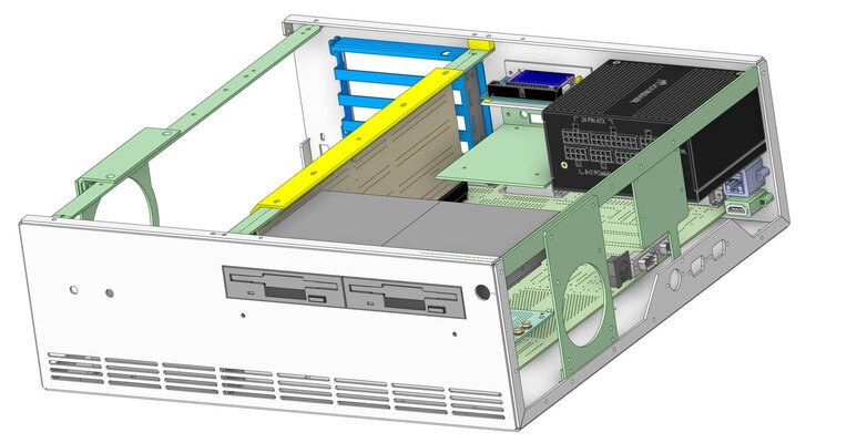

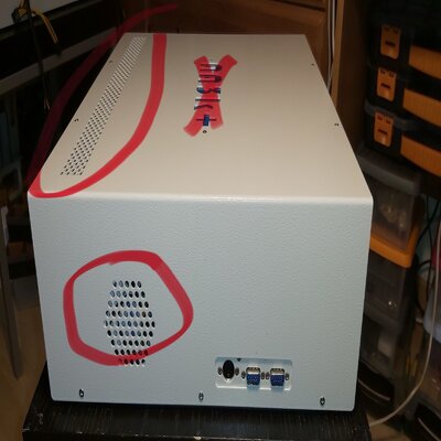

I would like to share with you my recent project. After creating a few custom cases (A500, A600, A2000 and A4000) the time came to turn my attention to the Amiga 3000.
I know that the Amiga 3000 is widely considered to be the most beautiful model, so please be gentle with feedback. Purpose of my project is to provide reliable, practical and sturdy solution for those without a case.

Instead of writing a long description I have annotated the attached images. Please have a good look.
Price of this case will be in region of 350GBP (painted, bare case with brackets and most screws) (FDD extension hub, DB9 and DIN5 extensions are optional at extra cost) plus packaging and postage (and possible customs charges).
I know that the price is intimidating, but please understand that this is not mass produced. I do it in my spare time and I can produce 1-2 pieces per month.

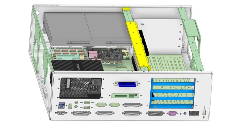

Full ATX won't fit. Some SFX may fit. I strongly suggest to get from me or eBay FSP250-50GUF. I only provide mounting kit for that PSU.
I thought that I am replying to different post.
Only SFX PSU fit that case.
I am working slowly to change this design and it will be powder coated black I think.
I corrected my previous reply. For my custom made case you need SFX PSU. PSU from link you attached is for my A3000D PSU enclosure kit.

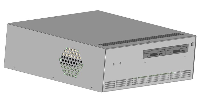

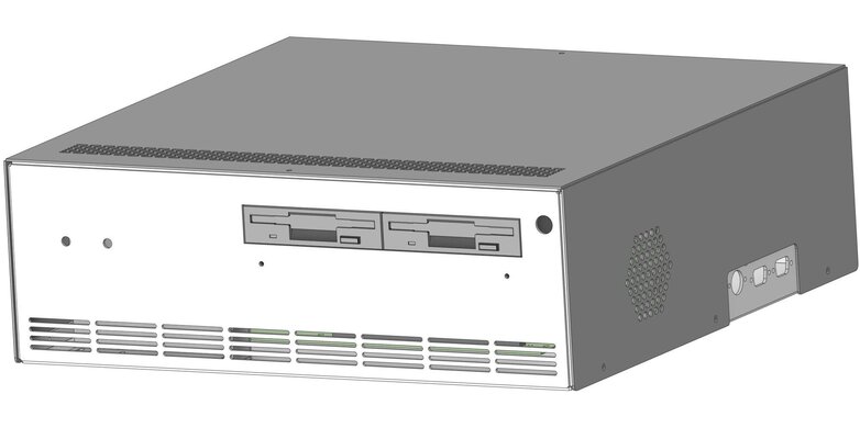

I have to order it as a set (top and bottom part).
I will do "plain" top and bottom but with vent holes, I am not going to produce sealed box as Commodore done.
NO SLOT for slim CD-ROM (too many issues).
Once I am ready I will open sale post.
I will try to keep price in same range as my A4000D case.
Please have a look at renders.

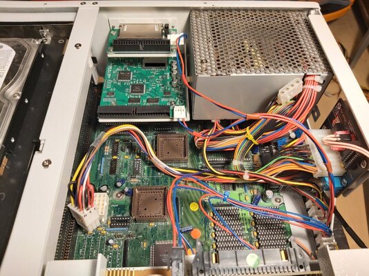

I will be interested in 1 or even 2 of the black 3000 cases. 1 for ReA3000 board, and the other for AA3000+ board. I just dont like losing a DB slot with putting the 3000 boards in Checkmate cases.
Can you create a 3D spline in the CAD program you are using that on one end is tangent to the middle ATX pin centerline on the PSU, and on the other end is tangent to the motherboard power plug pin centerline and measure the arc length of the spline? This is for length of custom modular power supply ATX to 3000 adapter wiring length.
I am away until Sunday late afternoon. I will try to do this after my return.
I understand that A3000D can work with simple cable loom when TICK is set to internal (what with -5V?). Is not critical?
Please check Google folder, there is place for ATX power adapter with TICK generator.
