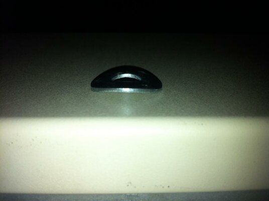

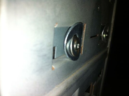

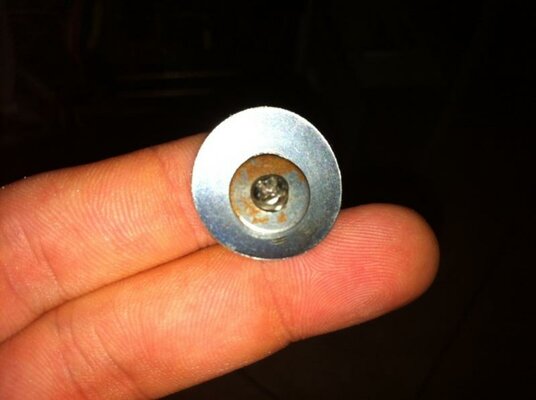

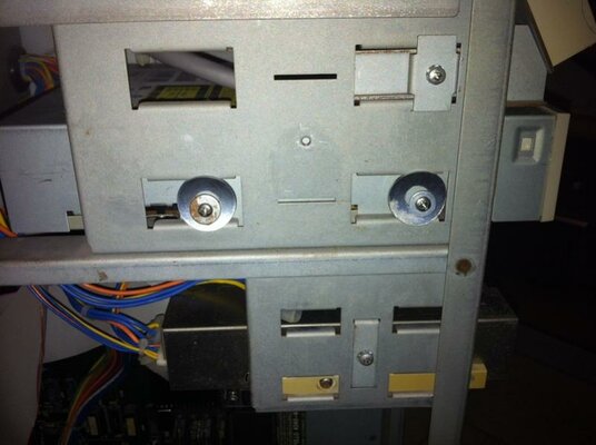

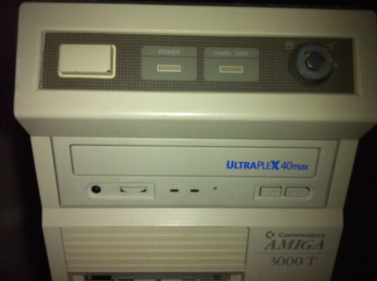

There is a really easiest way to fix properly drives in A3000T, unless you want original parts. I did fix my SCSI CDROM drive 2 weeks ago. Will take a picture tonight at home to show you if you want.
In fact it consists on taking 8 or 4 washers and 4 screws (depending on the size of the hole of the fisrt washer). 4 washers have to be curved (you can take flat ones and curve them yourself).
Pictures attached...
You can hit with a hammer it will not move ;)
