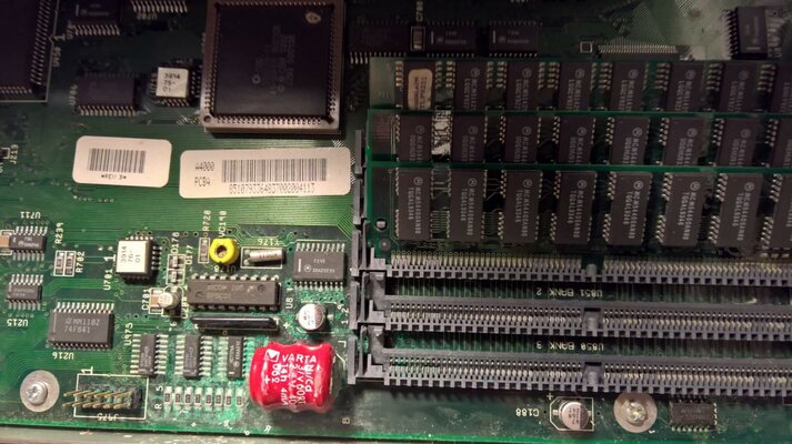

I'm hoping that some one might be able to clean up and fix up an A4000 that I got today.
the battery has leaked but surprisingly the machine still boots (but the mouse doesn't work right).
(higher res version can be found here: https://dl.dropboxusercontent.com/u/1153673/Amiga/WP_20160415_20_32_01_Rich (2).jpg)
If it can be fixed I would also be interested in a re-cap as well.
I've been told that it would be an idea to snip the battery and use lemon juice on it now to help save it. But I'm not sure if that you help or hinder any fix up attempt.
Doing this will certainly stop it getting any worse.
There are several members on here that can fix that up for you.
Hikey, Bebek and one or two others.
+1 for bebek. He rescued my A4000, and it was in quite bad shape :)

Unfortunately most of the pads and tracks/vias around/under HC174 are gone so RTC is beyond economical repair, also one 166 is half disoonnected so it will be moded to use only one for mouse and joystics (only one is required anyway) - work in progress.
