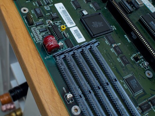

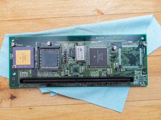

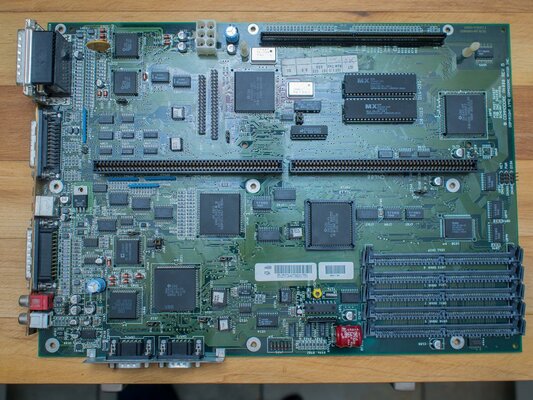

Hi, pictures as requested, as you can see a little discolouration around the battery but no corrosion to chips or track lines that I can see... the board and CPU card look really really clean underside is clean too.
Thank you for all the suggestions, I have tried everything above but still just a grey screen so any other thoughts would be very gratefully recieved
