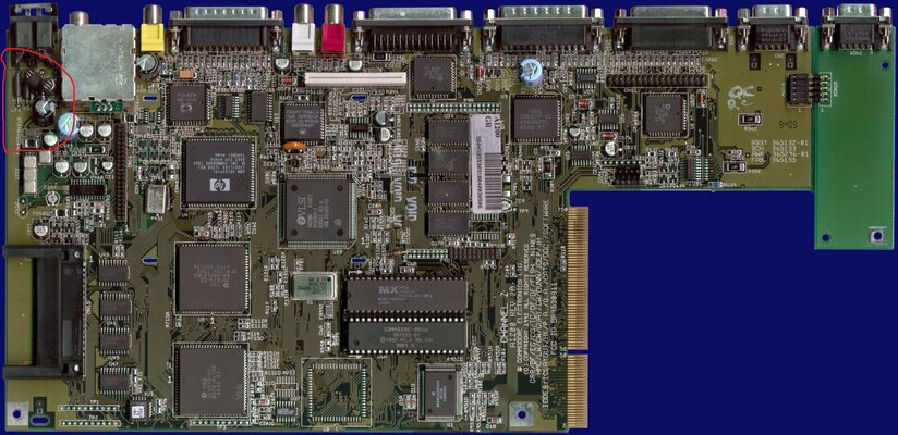

Hi All
I am searching for a Power line filter for on Amiga 500, 600 and 1200 motherboards.
as I have a new A500 + motherboard and I need this item,
I am aware there are no new ones of this item but do anyone know of replacement version of this?
see photo 1 for what i am after mark in red
photo 2 which is a1200 motherboard has a different power line filter and is this one easier to buy? like off mouser / digikey

I found this on the SukkoPera Raemixx500 GitHub readme : https://github.com/SukkoPera/Raemixx500
  • Alternative Footprint for the Line Filter: The original line filter (LF1) was probably a custom part, but in any case it's impossible to find these days. Luckily a functionally-equivalent part is available (Laird Z131B-10) but it has a different footprint, so the latter was added at LF99. Be very careful when soldering this, as it is very easy to make a solder bridge between the pads of LF1 and those of LF99 and short out the power rails.
So I guess one option would be to find a dead motherboard and salvage the component, or find the equivalent part above and somehow adapt it?
thanks, i did buy a dead Amiga and saved that parts i needed, sold this project awhile ago.
