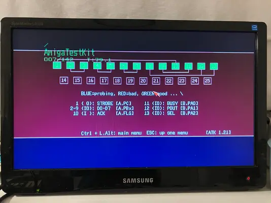

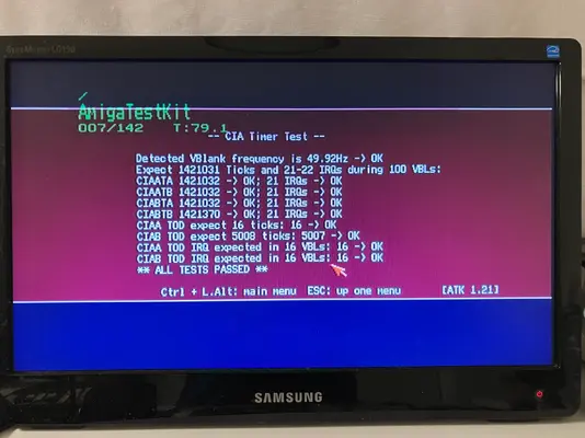

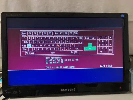

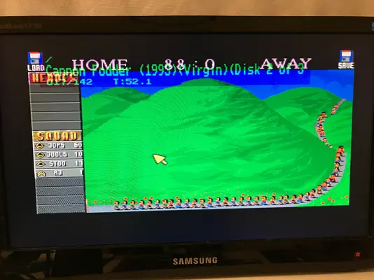

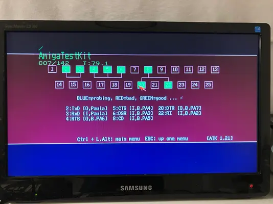

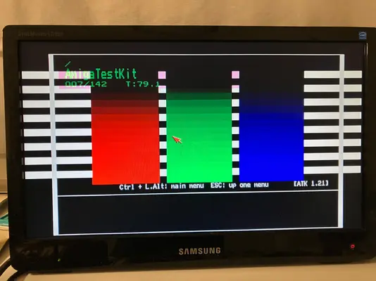

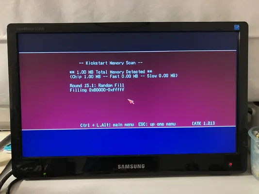

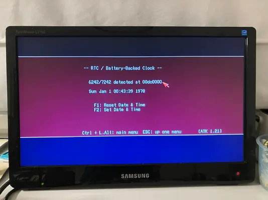

I connected the board, and the board booted to a well-known Kickstart 2.0 screen. I connected the Flashfloppy/Gotek drive and ran AmigaTestKit. I made all of necessary tests and made photos of results. All PASSED. Then I started Cannon Fodder and played 45 minutes until Jools and Jops died both at the same time killed by enemy grenade...
