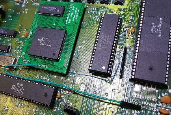

I've successfully upgraded a rev5 to 2Meg Chipram with no problems using the kit available here on Amibay :)
It requires some heavy soldering though but you are welcome to send me the board and kit and I will do it for you just for postage ;)
I have DjCook's MegaChip 2MB on my Rev. 5. I would recommend using trapdoor RAM instead of piggybacking the DRAM, because the extra height could interfere with the bottom of the keyboard (though maybe this only happens with Rev. 6A?).

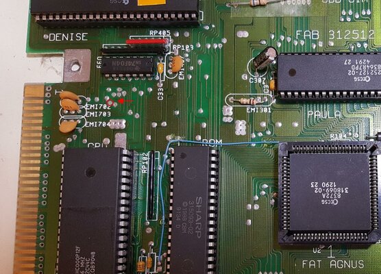

Also, I know of a nicer place to drop the A20 wire instead of tacking it to Gary, which I personally find pretty shoddy (and anyway I had to replace Gary.) There's a via you can simply solder a pin down into.
Is it the via above the zero of the EM1702 label? Due to the isolation on the jump wire it was hard to make out where it landed.
Option #1
I'll let the A314 add 512k chip ram via the trap door.. It'l configure the jumpers so that it's a 512K memory board then.
The MegaChip I bought ages ago from tbtorro will add an 8375 agnus and 1MB chip.
The remaining 512k chip is provided by the rev5 motherboard.
PRO:
- No ram soldering on motherboard
- Avoid possible conflict with keyboard due to ram height
CON:
- MegaChip might conflict with other expansions (accellerators, scan doubler, etc)
Option #2
Add 512k chip to the motherboard via this mod (solder another 512k on top of existing RAM).
Add the A314 as a 1MB chip ram board via it's jumper configuration.
Mod the rev5 to take a 8375 agnus via this mod.
PRO:
- Cheaper, doesn't "consume" the MegaChip. Leaves it free for my other machine. Also more spacious inside.
- Maybe more compatible with A314, "behaves like 500+" to it?
CON:
- Keyboard conflict
- More work on mother board, more risk
Any options I've over looked?
