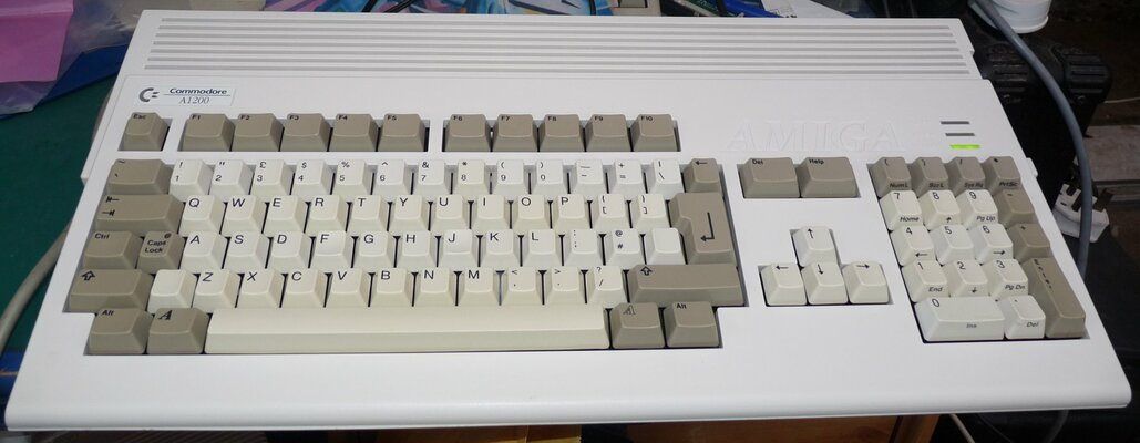

She's quite pretty, Keyboard is slightly yellowed in places, but the the case is in amazing condition!

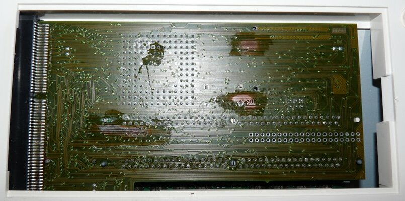

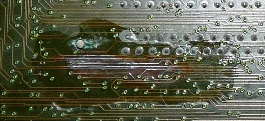

So I was with my friend Yorkie4 and we were finally building his 030 based A1200, in the midst of all this fun we discovered another 030 in my bin of broken Amigery bits - and as you can imagine it wouldn't run - after some testing and fault finding on the card, I discovered it was a trace that had been scratched through and cut -
So after laying down some thin 30AWG to replace the damaged track I then tested 2 other areas - after testing and it working (\o/\O/!!!Hurray!!!)
Now this might look wet, but its actually hard resin coat to protect it from any further damage =)

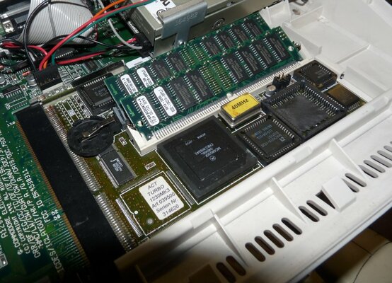

After testing the card with several hours of Demo / Frontier abuse I felt it was time to take the opportunity to upgrade the card to have additional memory, since I have some delicious 60ns FPM 32MB SIMMS and spare 72Pin Sockets - lets have some fun -
*Please note if you want to do something like this to your Apollo Mk3 - ensure you remove the Oscillator and the chips from the PCB where you can - last thing you want to do is damage them due to heat from the soldering iron.
So after about 10 minutes and a few moments inspecting and cleaning - this got bumped back into the A1200 -

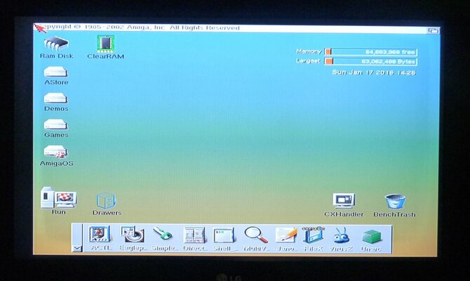

64 Megabytes of delicious 60ns FPM FAST RAM!! -

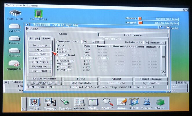

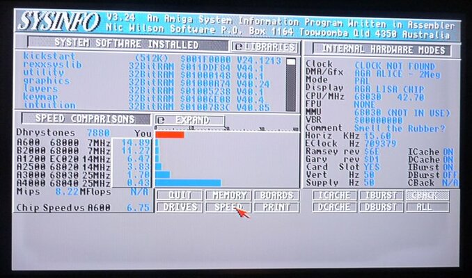

Firstly (as well all know and love) SysInfo
CPU0 - image-001.jpg - Not bad 8 MIPS!

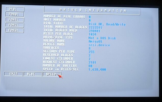

FDH0 - image-002.jpg - 1.6MB per second! (not bad for an 030!)
FDH1 - image-003.jpg - 2.3MB per second! (Yeah, not buying that ;))

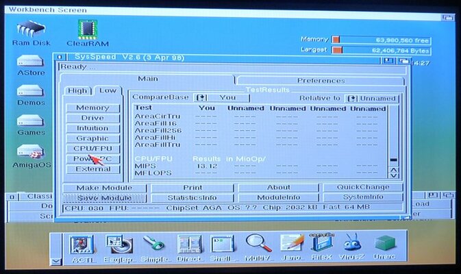

Secondly (a little more puritanical ) SysSpeed
CPU - imag-001.jpg -
13 MIPS eh, so how many Drystones is that?
- 2.3 Raw read of 2.3MB per second - impressive!
