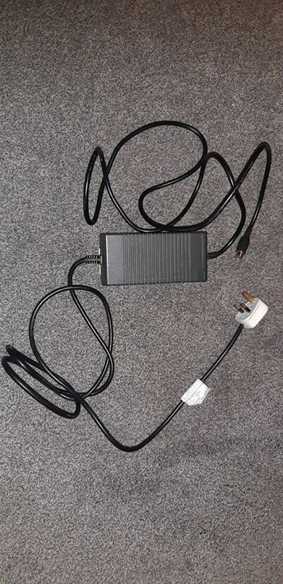

Why not make your own, is better and more wattage then the max 15w standard Amiga CD32 PSU, when the TF360 comes out it's
best to have a +/- 50w PSU, and the problem is that a very old PSU's (25+ years) can destroy your Amiga CD32, because of old bad caps.
I am going to make my own Amiga CD32 PSU from a MEAN WELL PT-65C, a good quality (with very good quality Rubycon caps) 64W
Switching Power Supply and that has +5 and +12 and -12 (yes i know the CD32 only needs +5 and +12), have almost everything,
i am waiting now for the 4 pin Male DIN Plug Socket Connector, then i have everything, and gone put everything in a Box Enclosure.
Plastic Electronic Project Box Enclosure: https://www.aliexpress.com/item/32893599444.html?spm=a2g0s.9042311.0.0.27424c4dtFvrAf
MEAN WELL PT-65C: https://www.aliexpress.com/item/33056153630.html?spm=a2g0s.9042311.0.0.27424c4dtFvrAf
PITCH Straight pin header + Housing + terminal: https://www.aliexpress.com/item/32868232013.html?spm=a2g0s.9042311.0.0.27424c4dtFvrAf
Silicone Wire Cable Tinned Copper: https://www.aliexpress.com/item/33005292688.html?
Rubber Grommets Retaining Ring Set: https://www.aliexpress.com/item/4000166798946.html?spm
Male DIN Plug Socket Connector: https://www.aliexpress.com/item/32860020971.html?spm=a2g0s.9042311.0.0.2c5c4c4dTQedqZ
3 In 1 Fused Holder Switch 10A AC 250V IEC320 C14: https://www.aliexpress.com/item/32854443760.html?
3-Prong 1.2m AC Power Supply Adapter Cord Cable: https://www.aliexpress.com/item/32849459443.html?

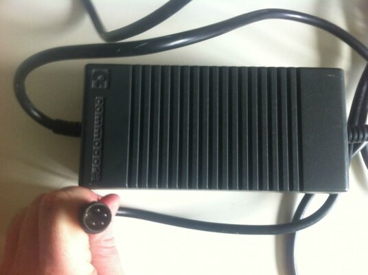

For a few pounds I was simply going to Recap the original 17W PSU hence the reason why I'm looking for the lightweight PSU version ;)
When I upgrade my CD32 I could simply place inside the original PSU case a MEAN WELL PT-65C... ETC. That way it will all look very neat and original :thumbsup:

Yes i done the same to my Amiga 500 Plus PSU, it stopped working, and just put a Makerele NET-50B in it, but that is not the best PSU you
can buy better buy a MEAN WELL PSU, has good quality Rubycon caps, and the Makerele NET-50B does not have good caps, so i replaced
them with good Rubycon caps, and put it in my old Amiga 500 Plus PSU housing, fitted perfectly, i did took the Makerele NET-50B out of it's
housing, did not use the housing for cooling had it's own heatsinks Luckily, and i also recapped my old 17W Amiga CD32 PSU, was easy.
And do not replace the caps with cheap caps, is NOT a good idea, use First-Tier Japanese Caps, like:

Naturally I use high temperature rating 105°C long life Low ESR Panasonic caps for my power supplies :thumbsup:
