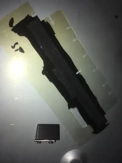

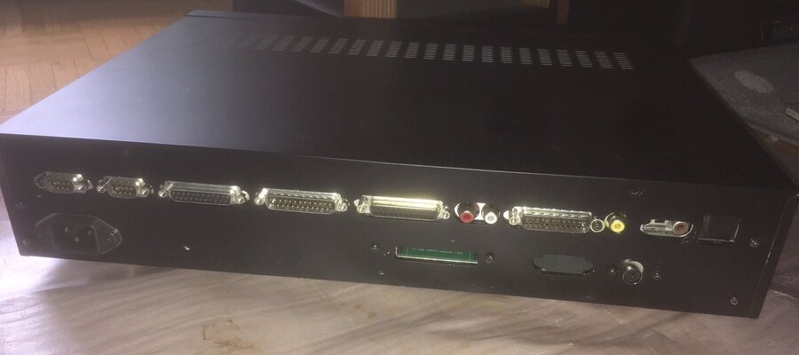

Well, this project is reaching final stages and I can share some near-done pics. First the A1000 got a 1200 AGA motherboard treatment, now the CD1000 got the same. I made a video of how the rear panel was cut...with a plasma torch! I'll post that soon.
Slot loading Pioneer IDE CD player in place of the original drive with left side green LED doing power and right side orange doing IDE, HxC floppy drive dropped into the display window and CD-LED doing floppy LED duty with Volume UP/DOWN buttons wired to HxC along with RESET for select button and SD card accessible from the covered front port. Going to put another accelerator into this in place of this ACA1221, Indivision with HDMI out, CF accessible from rear. It is going to be a heck of a setup with original CDTV external floppy, mouse, keyboard.

I realize my photos are not great so far, but I will remedy this eventually. Here is my custom front opening cover, with the slot-loading dust cleaner transferred to it from the normal CD-ROM drive plastic front cover as well as the modified CDTV eject button. I also painted the edge of the dust foam black to ensure there is no inconsistency in the appearance from the front. This is all held well by this plastic insert in the right spot under various secured points along with the button to trigger the CD open/close. This may seem silly, but it was very important detail to the project, as the original caddy loader, as you well know, has that drop-down-from-inside floppy-type opening cover to cover this large front opening. I couldn't have a giant gap in the fascia after I swapped in the slot loader CD, so this was important for functionality and overall aesthetics. I'm quite pleased with the outcome as externally it looks very clean. We know it was caddy loading, but slot loading very much looks the part now.
