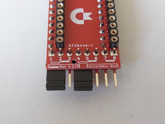

I made this "Amiga Kickstart Xtreme All Rev" in order to fix the problem with OLD and NEW revision motherboard like Rev4.2 (A2000) and Rev5 (A500) once and for all
You can use this "Amiga Kickstart Xtreme All Rev" for all Amiga 500, 600, 2000 motherboard ASSY versions , even based on EPROMs.
Please note that is equipped with machined pin gold plated

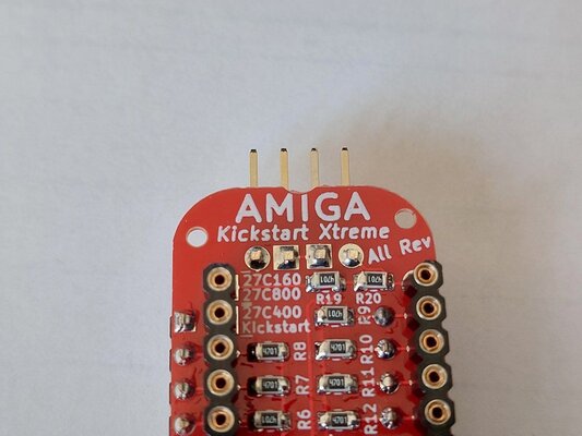

  • Presence of special jumper stripline (on the bottom with 1 to 8 pin) in order to use with different REV of Amiga 500 / Amiga 600 / Amiga 2000
  • Presence of special jumper stripline (4 pin on the top) where you can select A18/A19 address in order to selct up to four (4) images with Eprom 27C160. You can use a switcher on cable to switch your kickstarts/roms or you can use jumpers for permamently settings.
  • Simple and intuitive silk-screen printing to be able to mount an programmed Eprom with whatever you want (Kickstart/Amiga Diag Test or Dual Kickstart) or to insert the Kickstart and be able to use it on a version of your Amiga 500 /600/2000
Compatible with:
  • Amiga 500 (all revisions)
  • Amiga 600 (all revisions)
  • Amiga 2000 (all revisions)
How to install:
  1. Switch off your Amiga.
  2. Remove the Kickstart IC
  3. Put "Kickstart Xtreme" into socket
  4. Put Kickstart chip on top of the "Kickstart Xtreme" or your custom Eprom
  5. Set the jumper for use based on the REV version of the Amiga
  6. Connect a switch on/off (not included but I can do it) or select the address A18/A19 with the jumper (only if you use an EPROM with multiple images. If you use Kickstart, leave it open)
  7. Please note you can switch your Kickstart only when Amiga is switch off.

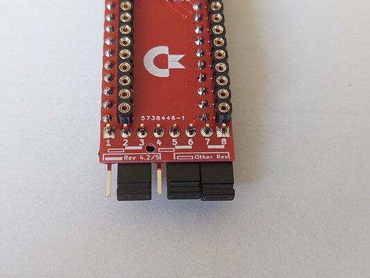

JUMPER CONFIGURATION:
CLOSED: 2+3 and 5+6 and 7+8
If you want to use it with old revision like Rev4.2 (A2000) or Rev3/REV5 (a500)
CLOSED: 1+2 and 4+5
If you want to use with subsequent revision >Rev5 (A2000) and REV6 (A500)
