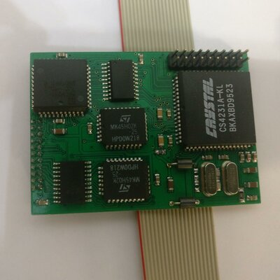

After some people asking me I'm selling prelude 1200 for amiga 1200 or other with clockport . As I decided to reproduce the pcbs as close as possible to the original with corrected patches on PCB which were patching the original boards.I decided to assemble some extra boards. I will make more if there is demand for it!
Boards were tested in audio playback with Play16, AudioFX and Hippoplayer in various freqs and also recording more than 2 consecutive minutes in an A1200 040 with AHIRecorder.
I found out that latest prelude.audio is not always the best, because it was made with prelude z2 in mind, so it has also options for add in boards as arpeggiator.So if you buy this from me I will provide the adequate drivers for prelude 1200.
I will ask for each 125€ plus tracked postage worldwide (some places to be confirmed) and paypal fees (I cannot escape fees, payment is always as goods).
As usual, and since this uses old components from NOS (CS4231A , MACH211 and 7202), I cannot give any warranty on those. I also ask when you install it to pay attention to board orientation, if you do this wrong, you can burn the prelude and your amiga.

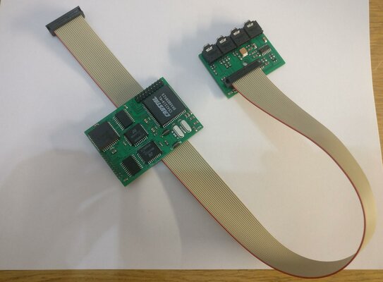

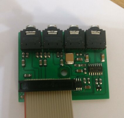

Is it possible to use one of these without the 3.5mm breakout board? I'm after being able to use a CD audio cable from an optical drive for an input, and another as output. If that is possible, then consider me interested!
Some time ago you sold several Zorro II Preludes. Will there also be more of those anytime in the future?
@Cozzer79 It's not possible I'm afraid :( it has a CD input though.
@torsti76 those boards are very expensive to make, right now it's not in my plans, maybe in a near future :)
Thank you for the info. I'll continue to monitor your sales... ;-)
