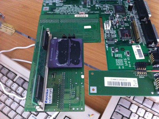

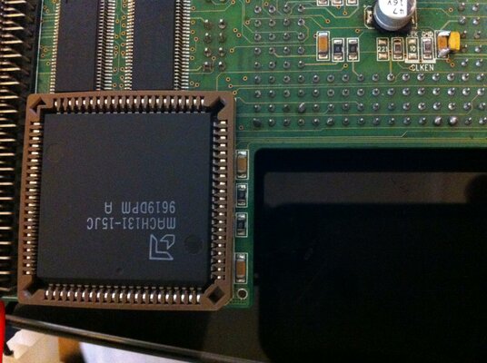

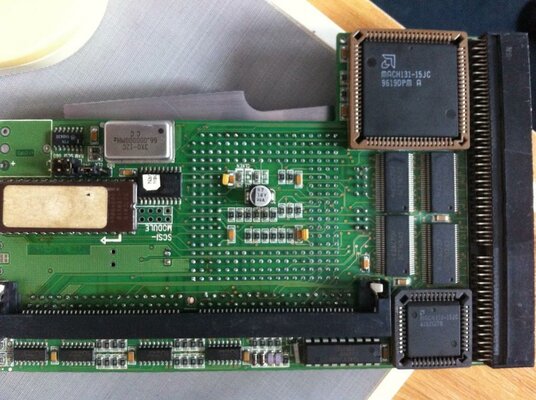

it might be the ram jumper on the card mike,try giving it a bit of a clean and bending the pins out to make the jumper tight.
or it might be that the mach 210 needs to be re-seated as well.

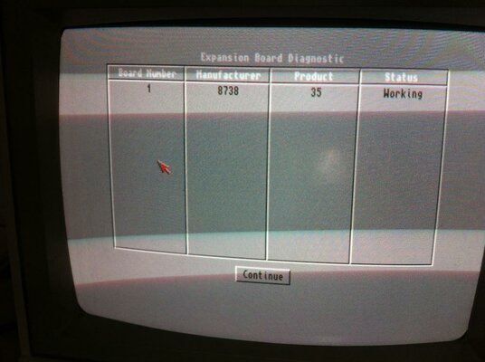

its still a result though.
cheers roy , I've just done that
popped both machs out and cleaned the pins & sockets with ipa
my friend should have a super stable card here me thinks..
i think you friend will be chuft to bits,not only has he/she got it back working its also a bit faster.

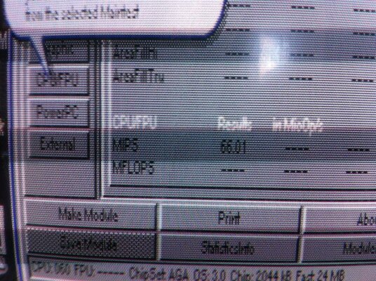

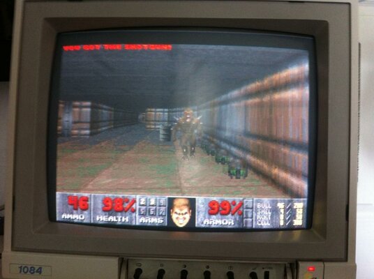

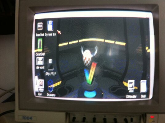

are those two videos supposed to be the same mike?
opps no they were different but i was very tired yesterday.

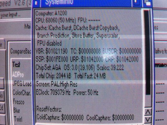

no matter same old stuff , one was at 50mhz and one at 66mhz. Just for the owner to see it running really nothing more.

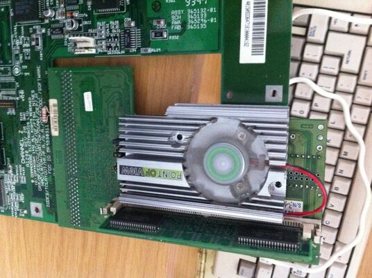

the XC does get warm at 50mhz and very warm at 66mhz. So i hope he bolts a fan on somehow.
I've supplied him with 50mhz and 66mhz crystals so he can play about with it.
