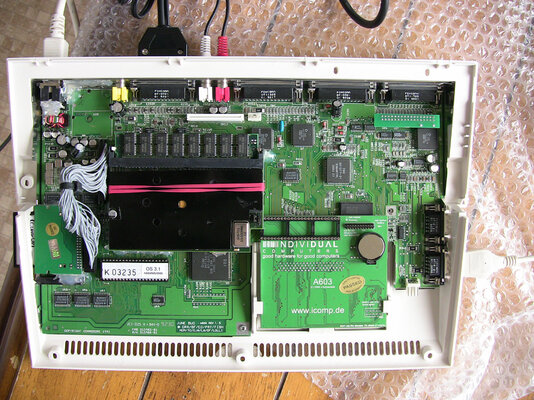

I was reading this info page on Amiga Hardware Database before my A603 arrived.
The page says that the A603 doesn't fit properly with the Apollo, and then also mentions that even with those two installed, fitting an IndivisionECS would be impossible on an Amiga 600.
Well, I decided to test that theory today.

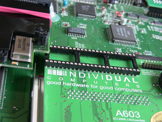

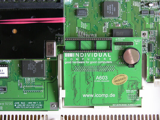

The Apollo does obstruct the A603, but I managed to 'fit' the Apollo on top of it - this has the drawback of Apollo being even less physically stable than before, and one of the Indy pin holes on A603 being covered by the Apollo!
So, as far as I can see, the Indy would be impossible to fit with those two expansions. I have pictures of the problem attached to this post.
Note: I am not actually sure if there could be a mod done.. would be a shame if that's the end of it though for A600/Apollo owners. ;-(

well it's a bit tight but you could replace the trace on the apollo with a wire, which means you could then remove the piece of board that's covering the offending pin slot, just a thought (y)

the socket wont be a problem, to be honest one can make a small extention using a 48pin DIP connector to 50wired SCSI cable and then to another 48 pin connector.
of course this means a little soldering.
although saying that, you are much better off just using some pin socket strips for extending 47 of the pins and just run a smidge of 30AWG from the bottom of the A603 card to the pin 48 of the extender.

Thanks, looks like I'm gonna have to if I'm gonna get around this issue. I had considered a home-made adapter like Zetr0 said but I'm not sure if that could create signal problems. From what I understand, the Indy is best as close as possible to the graphics chip itself!
@ All
Not sure if you guys can tell this from the first picture, but the A603 had to bend downward somewhat for the Apollo to fit at all. The only other option is to bend the Apollo, which is out the question because of how badly it fits already. Well to be fair, it fits quite easily.. just comes off very easily as well. *sighs*

There is an ingenious mod for this on the Extreme Amiga 600 Upgrading Page:
Click here
We'll need an additional socket though!
