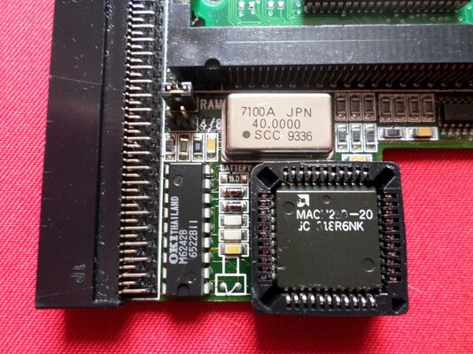

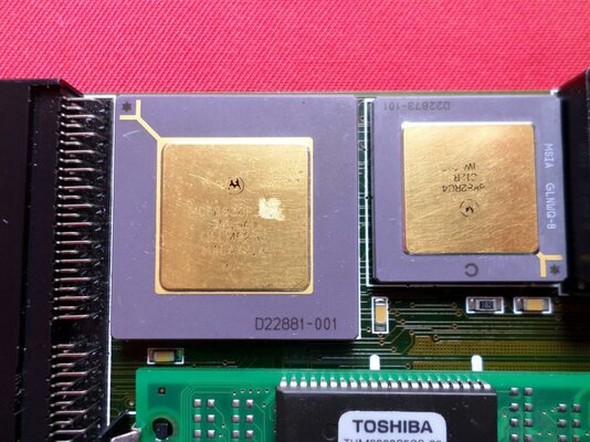

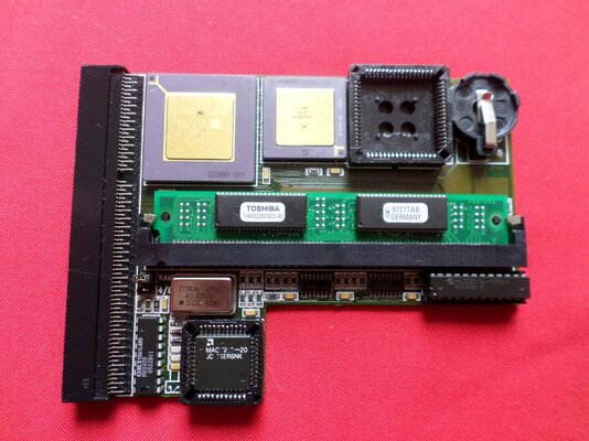

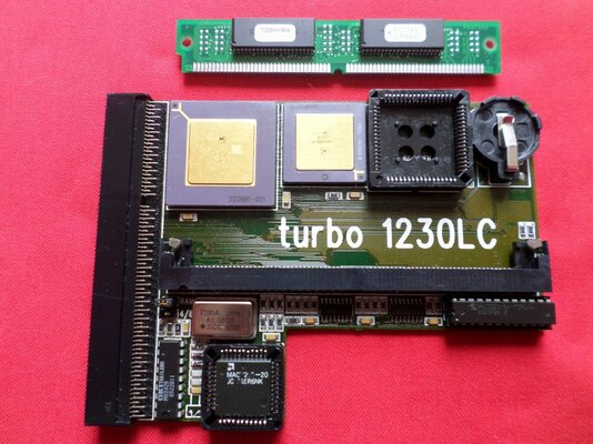

The second item is an Apollo Elbox 1230 LC:
I bought this card as faulty but it actually works. It was missing the two jumpers and, probably, the previous owner didn't see the extra memory and thought that the card was broken. However, the card has some issues. It gave me a yellow screen 2 times. I cleaned the contacts and this issue disappeared but, sometimes, I am still having weird issues like "guru meditation" errors on boot or simply a black screen. I noticed that the small capacitor between the oki chip and the mach plcc is missing. The two points are simply connected together with a small wire. Another issue with this card is that the clock doesn't work. I put a new coin battery cr2032 on the card but sysinfo simply says "clock not found". The card was certainly previously "fixed" since on the back of it there are many soldered joints that differ from the original joints.
