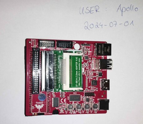

V4 FIREBIRD GIGA​
CPU Accelerator for A500/A1000
For A2000 we recommend the V4 SALAMANDER
For A600 we recommend the V4 MANTICORE
For A1200 we recommend the V4 ICEDRAKE
The new V4 FIREBIRD GIGA has all the beautiful options and features the V4 FIREBIRD offers you!
On top you have gorgeous 1024 memory DDR3 RAM, directly usable by ApolloOS, and Amiga OS, develop on your Amiga without limitation and finally you have enough memory to compile even biggest Amiga programs.
Allows you to play AGA games on your A500!
Key Features:
  • CPU: Apollo 68080 AMMX with 64-bit support
  • Memory: 1024 MB DDR3 (6 MB ChipRAM)
  • Video: SAGA RTG, Truecolor 32-bit, 1280x720 / 1920x1080 FULLHD
    Audio:8/16-bit, 56 kHz, 24-bit mixing, 16 DMA voices
  • powerful 3D MAGGI Texture acceleration unit (part of Amigablitter) with Hardware Truecolor texturing with Bilinear interpolation and Light and Shadow, Gouraud and Zbuffer support
  • 2x FastIDE controller (CompactFlash and CD-ROM)
  • USB ports (for joypad/mouse)
  • 100Mbit Ethernet RJ45 port with DMA
  • Digital Audio/Video out
  • Build in flickerfixer / enjoy interlace Amiga screens without flicker!
  • AGA support - play AGA Amiga games!
  • microSD card port (for data exchange)
  • EXPANSION PORTS for adding more

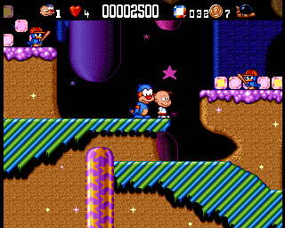

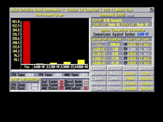

This card allows you to finally play AGA games on your Amiga 500.
You can natively play Amiga AGA games like Aladin AGA, Banshee AGA, or Reshoot AGA
Bonus: The Accelerator Card comes ready to use with IDE/CF Adapter and with CF Flashdrive preinstalled with ApolloOS.
From our latest production batch I can offer you 2 cards.
These cards are brand new and come with warranty.
Price for outside Europe Union €588 plus postage (price is without VAT)
Price for inside Europe Union €699 plus postage (price is with VAT)
