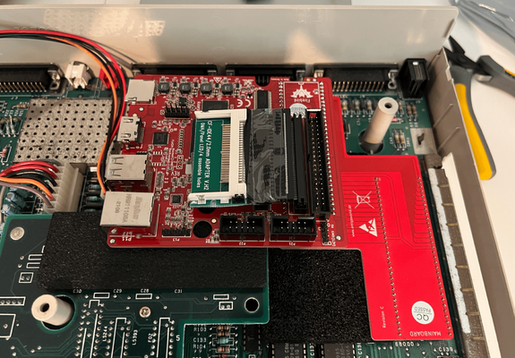

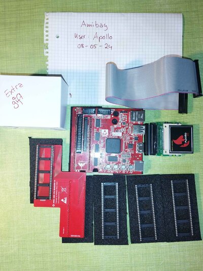

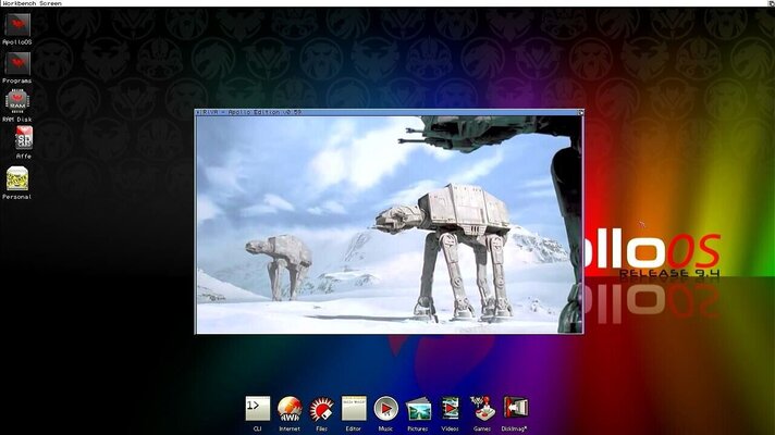

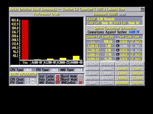

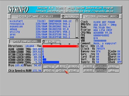

The Shapeshifter assembly kit is designed for the installation in the Amiga 1000,
It was tested with both Amiga 1000 mainboard verisons (with and without piggyback daugtherboard)
The Kit comes ready to use with:
-3 high precision CPU Sockets for extra clearance
-Floppy cable
-IDE/CF Adapter
-CF Flashdrive preinstalled with ApolloOS
So you only need to plug the card in your Amiga 1000 machine and you can use it immediate,
