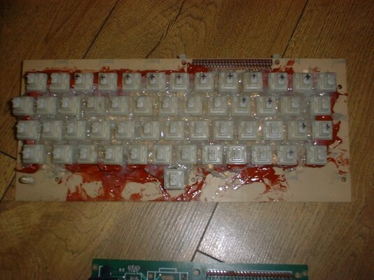

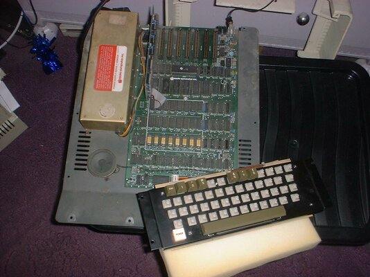

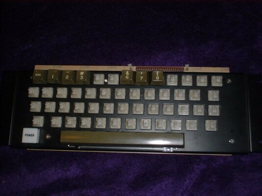

I have an Apple II Europlus which was gifted to me decades ago ..
I had never seen it function and parts are scarce ..
Having recently plucked up the nerve to tackle this computer ..
(I have worked on many 8 bit computers ..but mostly commodore...this is my first Apple)
I eventually got the main board and one of the floppy drives working..
BUT a major problem was the keyboard..
over 80% of the keys either didn't register or had damaged internal return springs...or both.
Unlike commodore keyboards Apple II KBs cant easily be serviced..
I searched for a long time and couldn't find a replacement ..only ebay vendors asking stoopid prices for individual key switches ..
..and I needed a lot..
Recently I managed to buy an Apple II clone KB on amibay ..but of course this was a gamble.
Sure enough ..it was different ..both electrically and mechanically ..

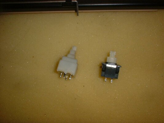

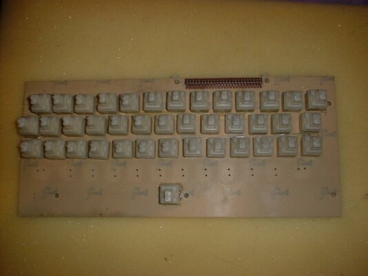

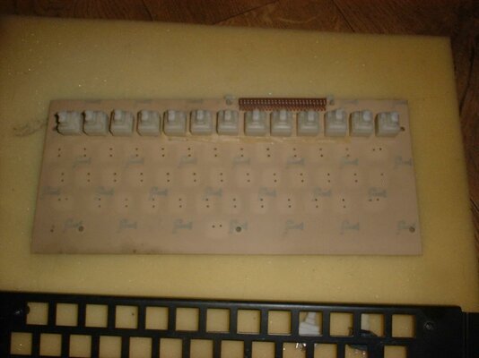

So ..My only option was to try removing ALL the key switches from the clone KB pcb ..and somehow fitting these in place of the original Europlus Key switches..
Sadly these are physically different ..use thicker wire legs ..and those pins were at right angles to the original..
PLUS ..these do not mount from the top through square holes as do the original Key switches ..

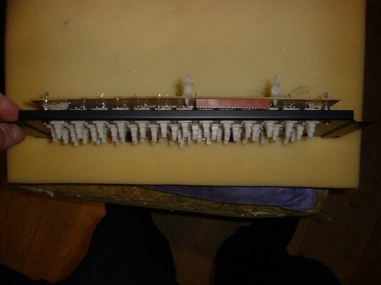

After giving it some thought ..I figured I might be able to mount the clone keys of extended wire legs ..rotated at 90 degrees ..and under the metal KB plate rather than through those holes ..
I'm attaching some photos later to show how this was achieved ..and although so far untested ..looks like it may well do the job..

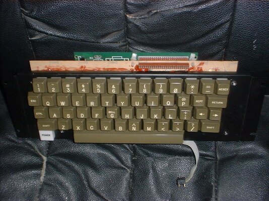

Some pics to go with the above description..
rgds
VS

Hello,
Might I be the first to say that's an excellent bit of hackery you've done there. I do hope your Apple II comes fully back to life in the near future. I relatively recently got a IIe and really enjoy fiddling with it although I have a sympathise with your issues - bits 'n bobs for these machines are too expensive.

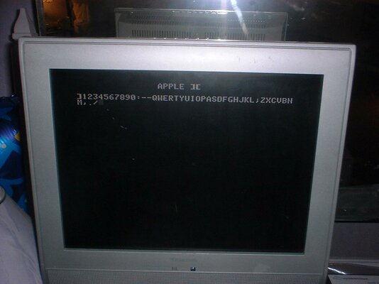

Thanks Charlie..
So ..
no more work on the KB today ..
Tomorrow I may try and squirt silicon under the key switches to provide support to the wire legs..

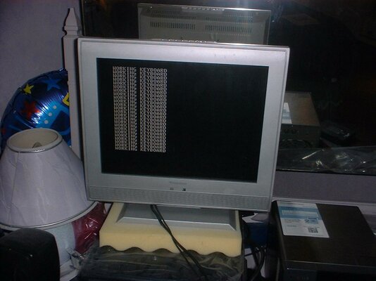

But I couldnt resist a quick test ..
did it work ?
well see for yourself ..
pix attached..
rgds
VS

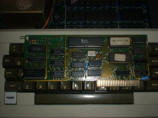

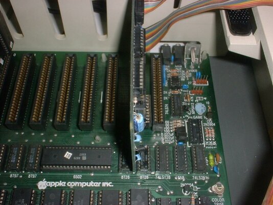

Questions for you Charlie if I may ..
I also bought a perfect 80 card along with the KB ..
and since I know nothing about Apple ..
I am assuming it goes into slot 2 ..as this is the only slot in which it appears to operate without causing continuous beeps at switch on ?
Are 80 column cards slot specific ?
Also ..there is a 2 pin connector on the card ..
does this provide composite out ..and will I have to make a suitable RCA phono adapter to connect here ?
Finally ..
I'd like to get colour out of this 8 bit eventually
I assume I would need yet another card to achieve this ?
what would I look out for ?
PAL or RGB ..
..and with RGB ..could I use a conventional RGB scart in on a TV ?
cheers

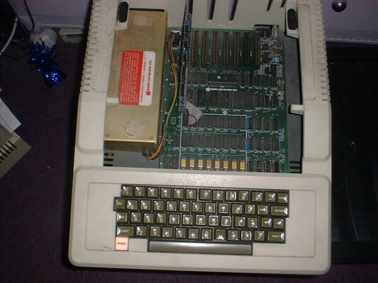

..Not the prettiest job I ever did ..
Some of the keys are uneven ..and the M key was a bit of a bodge ...but it is complete and functions well..
.I must remember to treat the keyboard gently and not press too hard is all.
I guess it will do until I get something better ..IF EVER.
lol

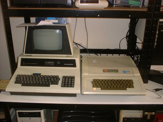

I'm scared to leave them both on their own in the same room ..
Worried in case a fight breaks out..

Marvellous job there... now if you can introduce a Trash-80 to the mix we might just get the earliest example of Super Smash Bro's.
On the subject of your questions my knowledge is patchy at best, hopefully others will weigh in shortly but for now:
Unhelpful answer: Swap the motherboard for a NTSC IIe version. Why commit such a horror?
-If that 80col card is the one I think it is you'll likely need a motherboard with the extra slot near the front of the PSU. If it's a 'proper' older after-market II 80col card I, um, don't know. Is there a manufacturer's name / model number that might be googleable?
-The way the Apple II produces colour only works properly in NTSC. (thankfully a lot of TVs/monitors can cope) I have a very vague understanding that the Euro II was either B/W only or there was an RGB card for it. I have a feeling the Euro II has a pin-header near the composite out for an RF upgrade (so PAL and Colour possible that way) but I may be spouting nonsense.
AFAIA: pre-IIe Apples were endlessly upgradeable / hackable for such upgrades but currently outside the meagre scope of my knowledge.
Sorry that I've probably just been wholly unhelpful.
Thanks for replying Charlie ..
I'm attaching a couple more photos ..
one of the Perfect 80 card ..and one of the rear pins near the AV out on the Apple main board..
I'm hoping someone knows ...something that will help me out..

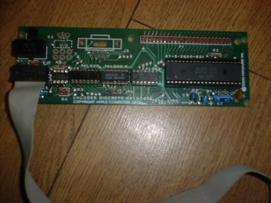

A follow up to my keyboard build ..
I have been running it for a few days now ...and there have been some oddities..
Sometimes after quickly rebooting (power down) ..the Apple starts producing on screen the last key pressed ?
Sometimes characters appear on screen after the cursor ..without any key being pressed ..phantom fingers ?
Some of the keys produced multiple occurrances of the key just pressed..
Not all keys suffered from this ..just some of them ?
There is a switch on the keyboards sub pcb ...and I didn't know what this was for so just clicked it over ..
Even more anomalies of the same type ..?
I believe this is something to do with auto repeat of the keys...if anyone knows for sure please comment.
From the limited info I found on the net ...I may well be looking at the 40 pin keyboard encoder chip faulty...but fingers crossed this is not the case ..cos it's rare.
Tracing back from the switch ..which seemed to make things worse...I came to a 555 timer ...
This chip appears to be used as a latch ...so possibly what enables single press or key repeat.
Ok ...not sure how this works ...but I removed all the chips on the sub pcb ..and fitted bases to make removal easier.
..all chips back in place ...and no change ..
OK I thought ..what if I just remove the 555 latch and leave it out ?
Well ..this appears to have fixed the problems ..so far that is.
I dont need key repeat anyway..
But I will try replacing the 555 when I have one (on order)
regards
VS
It's funny how life can throw up coincidences, my IIe started playing the same game a few days ago. "Uh-oh", I thought. "Is that the keyboard encoder up the proverbial?"
I found a very helpful fault diagnosis .pdf for the Apple II that helped a lot. I presume will be of some help with your model.
In a nut-shell it may be the encoder IC, but you may have the same issue as me - a bad C71 cap. Swapping it for a new one fixed my machine. (Little ceramic jobbie close to the notched end of my encoder IC on a IIe board)
I'm at the wrong computer ATM but I'll hopefully post that diagnostic .pdf in a bit. Best of luck.

I do love posting pics dont I ..
lol
Here are another 2 .
Showing the silicon injected around the wire leg mounted keys for stability ..
and one showing the KB sub board ..
the cap in question is C5 on my board I think..
..and the empty 8 pin socket is for the removed 555 chip.

Genuinely awesome work with that keyboard! I say that both because you got it working and for making Heath-Robinson proud.
I really must get the the computer with that guide and post it...
IIe for £250.00? If I remember correctly that's about £100.00 less than I paid for mine so I'd call that a bargain. IIe vs IIe enhanced? From my point of view I'd say the latter is better but there's not much in it. Also if it's not an enhanced the difference is a couple of ROMs and changing the 6502 for a 65c02, so not a biggie if you decide to go for it.
Speaking as a relative newbie to the Apple II (I've had mine a little less than a year) I got quite attached to it pretty quickly. Old-school 8bit design, which makes it more comprehensible compared to later 8bits, while good/expansible enough to be fun to play with. (TRS80 Model 1sand PETs are cool but not much fun in the longer term, IMO)
It's very easy to have grounding problems on old A2 keyboards, and they act erratically when it's not right. You may have some dodgy connections or some grounding issues still if you rebuilt a keyboard from scratch... Check from the ground connection on the motherboard (where the keyboard attaches) all the way around your keyboard and also flex the board and press down keys to make sure it doesn't break grounding...
