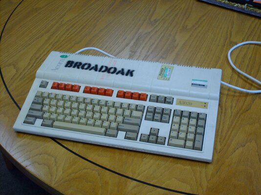

Here's a picture of my new baby... she's going to need some cleaning and possibly a new coat of paint. There are dotted security marks on the top that will need filling in and painting over to hide them. This is apart from the over-the-top black spray paint job!!
I think I can get some water-slide decal paper to replace the logo afterwards, then lacquer over the lot to finish the job.
