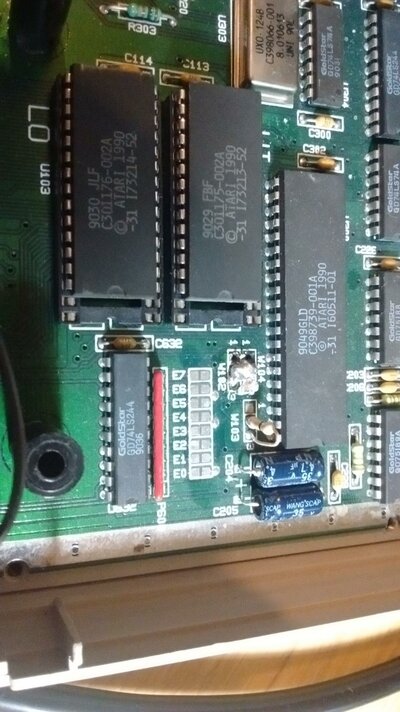

Hi this is my first ST. I was under the impression that ST booted to its desktop without a disk?
This machine just gives we white output and appears to continuously reboot?

Its been about 5 minutes now.
I have managed to find a couple of games disks that boot into their game so machine is not totally dead.
Any ideas?

Yes drive clicks a couple of times, then screen flashes, repeat
Going to take a wild guess that this might be the issue!

Other disks it sounds like something is ready 1 track, then screen flashes and it repeats!

Well I think I repaired that soldering mess successfully.
The machine will now click the floppy disk a few times then go to a screen of bombs!

that soldering is to select the "ROM" chip size and type ?? could it be set to the wrong type and thats why it bombs ?? most games don't require the rom to load.
have you tried taking the ram out and using just one stick at a time ?
