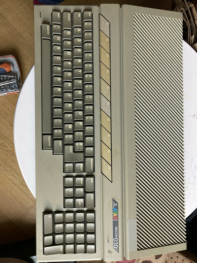

Hi there.
As an Amiga user, i never liked the Atari ST at the time around 1990, but i always respected the Falcon which was better than the stock A1200 at launch in late 1992/1993.
That's why i bought one about 10 years ago, but i have never used it so far except for a few tests.
It happens i have juste found it again in my junk.
Would appreciate any insight about the computer and how to max it out in its desktop form (no CT60 and PSU outside the case). What are the accelerator options, how do i connect it to modern LCD, to the internet? What RAM besides the 14 MB expansion? What can i do with it to match my Amiga of 2023? Are there any good resellers of parts or reference forum or website?
Thanks to all.

Well you probably don’t want that old relic of a computer so instead of binning it feel free to send it to me. I have lusted over the Falcon for a number of years now. It is a beautiful machine.
Haha but did you notice the french layout keyboard? Surely you wouldn't want to type on that?
CT60e (e stands for evolution) is a modern take on the CT60 and CT63 - you can use it with a pico psu to maintain the desktop form without need for an external psu. You can add up to 512MB ram with this. Mine runs at 100mhz without issue, apparently it can be clocked to 105 or even 107mhz.
Connecting to a monitor without using an adapter requires a vga cable. Alternatively if you can find them then both CTPCI and SuperVidel are RTG-like options, but both are rare and expensive.
You can use something like a netusbee (a cartridge) to add Ethernet capability - drivers work both under TOS and Mint.

Apart from the 68060 accelerators, is there anything in between the stock 68030@16 and the top of the range?
What is a good source to buy hardware for the Falcon?
I have found at Lotharek's the netusbee and a new 14 MB RAM upgrade (mine had an angled simm socket and didn't fit well in the desktop with the shielding.
Also, if i am not mistaken the OS is totally in ROM with the Ataris. Seems i have a chip with TOS 4.0 and D added with a pen, copyright 1992. Is there any better OS?
About hard drive, what is max size?
Yes, there’s an open source 50mhz 030 accelerator board here
There are threads on this on Atari-forum and exxos forum too
