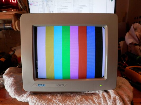

I have an Atari SC1224 Colour CRT monitor that is dead and won't power on.

i gave it a bit of a look over ,it looks like i will probably be able to fix it
itll just take a while,and it needs a clean

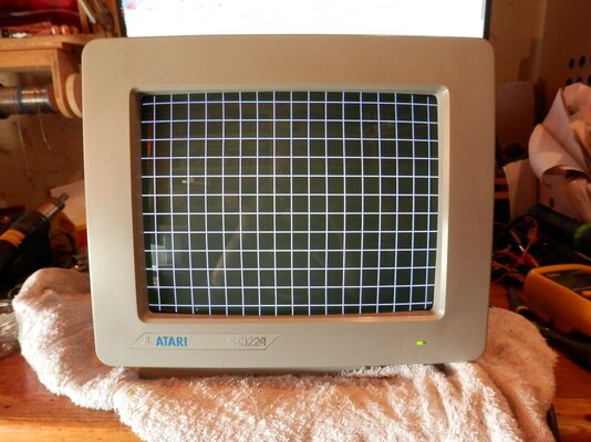

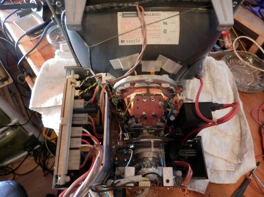

this is now repaired i think
power supply was dead,so replaced the str-41090 and ktc2120 (2sc2120y) cleaned it up and sorted out the cold solder joints everywhere
after i seen it up and running i noticed the pincusion control didnt do anything and was badly barrelled,turned out to be a bad transistor a 2sc1815
here are some pictures to look at and show it works,one extra one with the back off,some of you like to see the guts of monitors :)
