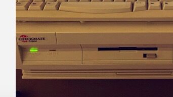

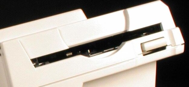

For those of us who bought the new replacement Amiga 1200 cases in Black and Checkmate 1500 in black, the lack of a good black floppy button solution sucked. We see these, and we touch them often. The right button doesn't come with the 1200 case (and they aren't offering a correction apparently, I've asked), and none come with the black 1500. 3D printing is a nice stop gap, but it doesn't look right. Paint on original buttons is no good because it will wear out quickly due to touching.

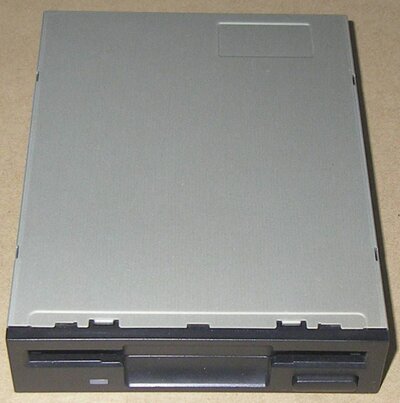

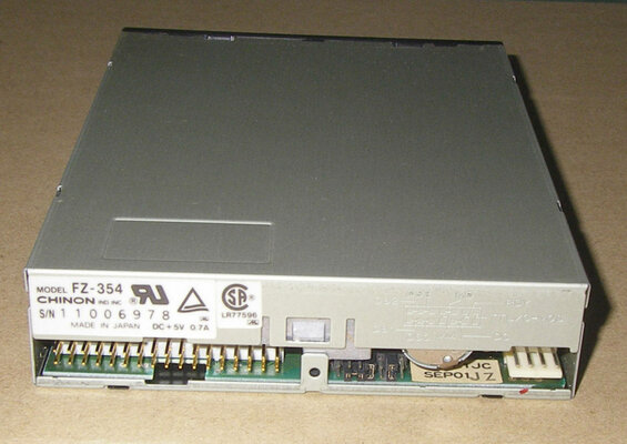

Well, imagine my surprise, when I learned that Chinon FZ-354 and FZ-357 drives came in black! They exist, and of course the 354 works unmodified and 357 can me modified relatively easily. The 357 ones I bought at a very reasonable prices are Malaysia made, so when they arrive perhaps they may be versions that can be modified to do HD floppies on the Amiga. Forgive if you knew of this black Chinons already (I can be slow to learn things), but I didn't so I thought I'd share.

Even with the black Chinon drives, you may still have an issue of the original drive buttons being too short for the A1200 case. I had this issue when I was trying to use modified pc drives in A500s. Luckily, I still had original Amiga drive buttons which I was able to slighly modify and mount onto new drives (of different brand). They are slightly crooked, but work fine. Just my 2 cents.

@damiraga - oh boy! So my excitement maybe premature? Hopefully, as the drive model is the same, it will be a drop-in.
I'll report when they arrive. 357s will be here soon. 354, that was from Japan, and I'm shipping it surface, so there won't be button function confirmation until Valentine's Day. :)

Makes sense Boing-ball. I bought that 3.5" bracket too for the case - is that what you're using? But I also bought the internal floppy drive face bracket to get that 3000 look, and to have it be clean. First, no black buttons on the Amiga internal floppies at all. But these Chinons are the ones used in a 3000, right?
I just want to avoid this outcome in the black setup.

FB354 and FB357A were the ones used on the A3000s. Early A4000s used FB357A as well, while the newer ones used FZ models.
If you are going for the genuine A3000 look with the checkmate case, note there were no black FB35x floppy drives and buttons (except for the very rare A3400 prototype which if I remember correctly used the FB model).
I suggest you either go with the beige FB354/7 and paint the rare A3000 floppy button the best you can, or go with the standard size black FZ model and see how you can make its button fit.
BTW, I just checked my A1200 and I believe the FZ model and its button will fit perfectly. You will have to cut portion of the drive top cover though to prevent hitting the case floppy drive opening. Hope this helps

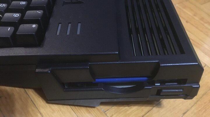

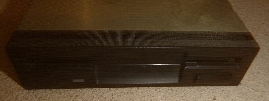

Even though we're familiar, here is the 1200 floppy side FYI. To me these black Chinons looks very promising. 1200FloppySide.jpg

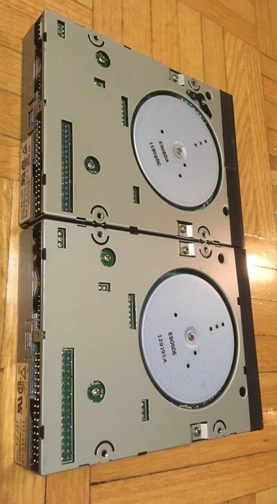

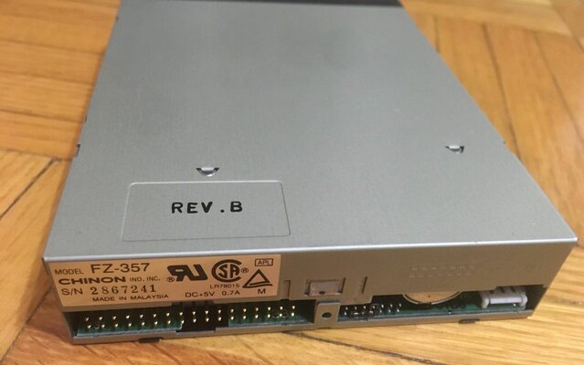

Well, the FZ-357 arrived. I can confirm a few details. Button fits, looks great, works great. I have to loosen the screws and nudge the floppy drive toward the front a bit for perfection. The button on these internals doesn't stick out as far, as a consequence it doesn't stick out as far out of the 1200 case as the original button. That's quite fine actually, makes it look a bit more stealthy and won't take any impacts. Works fine and the travel is very short on these Chinons anyway. It goes flush with the case without disk, it sticks out perfect amount with disk.
I can also confirm the FZ-357 works perfectly in the 1200 without any modifications. I got one of each MADE IN MALAYSIA REV B with the straight motor print that indicates that it is modifiable to a Amiga HD floppy drive. And a MADE IN JAPAN, which also has the straight motor print, and works perfectly in the 1200, but not sure if this MADE IN JAPAN can be modified for the 1.76MB capacity. Either way, both work as Amiga floppy drives with a straight drop with the addition of the last 2 sets of pins on the right shorted vertically in addition to what you see in the photos.

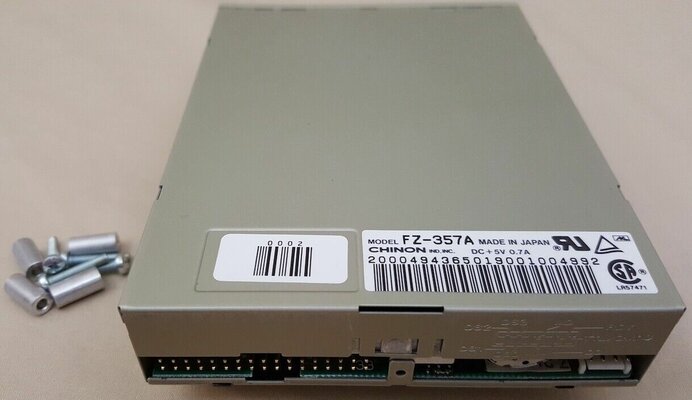

In the lot of two FZ-357 drives I received, one meets the requirements of MADE IN MALAYSIA and straight motor print. Funny enough, there is an authentic 357A for sale out there (photo), and it shows a MADE IN JAPAN mechanism, like my second FZ-357 drive that's MADE in JAPAN with straight print (photo). They both apparently came out of same model ROLAND keyboard.
