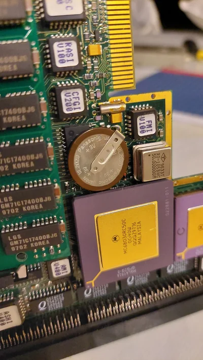

Hello,
It's perhaps a silly question, but does anyone know how to replace the real-time clock battery on a Blizzard 1230 mark IV accelerator board?
The one on mine is nearly 30 years old now and long gone. The problem is that it appears firmly fixed, perhaps welded(?) onto the slot? See picture for what I mean. I tried lifting it with a flathead screwdriver but it wouldn't move a millimeter. Anyone has successfully replaced one?
Thanks for any suggestions!!

hello,
the VL2020 is a Lithium Accumulator and can recharged, mostly even after many years of deep discharge!
Simply power up the Amiga for >10 hours and test the Clock.
If its recharged ~1 hour powerup every 6 Month to recharge are sufficient...

The battery is soldered into place. Have removed and replaced a couple. Have a look for VL2020 battery on the other bay. Usually show up for BMW key fob batteries.
As others have said. It is a rechargeable battery which takes power to recharge when the Amiga is powered up.

Ok! In case mine is gone (which is reasonable), can I simply desolder it with a soldering iron? I see no signs of solder on the battery but instead what looks like spot welding, which I know nothing about, so I wonder if heat is all it takes to unweld it.

The battery is held in with 2 soldering points underneath the card. Just desoldering those 2 points and the battery and what looks like a holder (It isn’t) will just come out. Then replace with a new similar battery the same way round.
Just be careful not to overheat the board as you may cause damage to the pads.

I actually found time to test it repeatedly these past few days and the 30 year old lithium battery works!!!
I set the time on the clock and left the Amiga on for a few hours to allow it to charge. Turned it off and the following day the time was still correct. Left it off for a week, turned on again and time still correct!! I am not sure how this is possible, may it live another 30 years!
