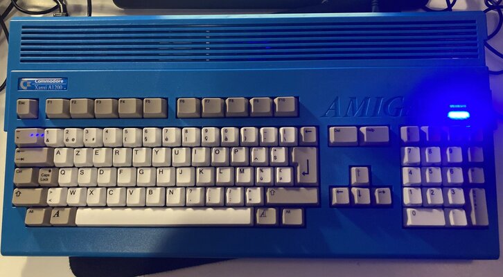

Here is a picture of that computer. Should have been a nice story of blue case, blue LED, blueSCSI and bluzzard 1260. Instead, i have installed an IDE to m2 SDD as i usually do. This computer is a clone of my other A1200 with Blizzard 1260 except for Amiblaster CP and Freeway USB instead of Subway on a Gayle adapter clockport. The weird thing is that the other one gets 2,5 MB/s from its IDE port and this one only 1,6 MB/s with same combo of upgraded SCSI device, NSDpatch and IDEFix (was 1,2 MB/s and 1,4 MB/s with two different IDE to SD adapter and the RDB SD card that i used also with the BlueSCSI). That computer seems to want slow hard drive access.
