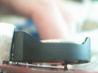

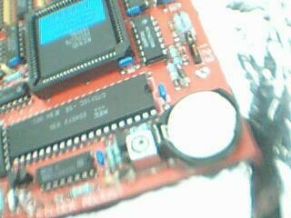

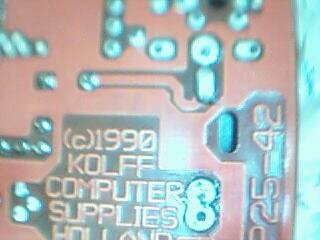

- If I decide to install a new battery socket for coin batteries... which battery I need? one standard CR2032 3v? Maybe anoter one?
The identical replacement battery is the Panasonic VL-2020 (rechargeable). Same as on the Blizzard 1260, 1230 MKIV.
These are easily found on ebay because they were also used in the key of some BMW model(s).
You can buy it either with the +/- 'legs' already punched on for a direct installation, or as just the coin if you source an appropriate socket.
The CR2032 + diode will do fine as already suggested but I am not sure the legs of the standard socket will fit! They seem to be wider apart compared to the VL-2020 assembly, you should verify this.
I desoldered a standard CR2032 socket from a PC motherboard to replace the dead battery on my KCS Power PC board (which had punched-in legs) only to face the problem I mentioned. I had to hack the underside of the socket a bit to shorten the legs' distance so it would somewhat match the board's +/- holes. I don't know if sockets with shorter legs distance exist.
