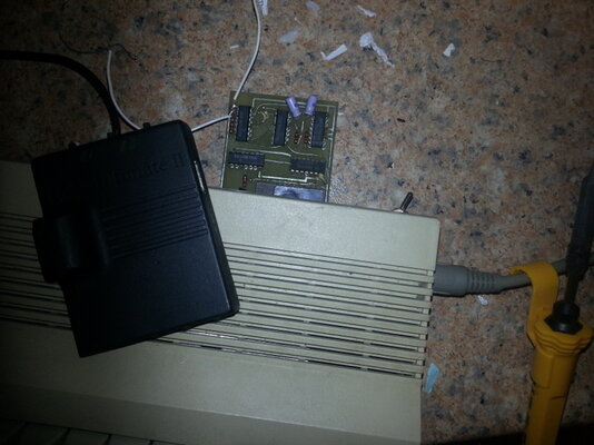

C64 hardware - anyone know what it is?
Starteck2002
Dec 19, 2013
117
England
Durham
2013-12-19%2018.31.18.jpghttp:
Obviously it's a cartridge :-)
It has a wire coming off one side with a plunger type switch on it. I suspect it may be some kind of reset cart (action replay) but don't really want to plug it in and find out. Large version here: https://www.dropbox.com/s/fto94o2w1djs95d/2013-12-19 18.31.18.jpg

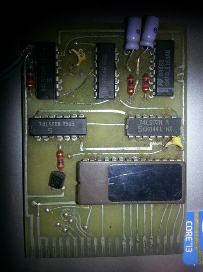

Pay attention to the two wires at the top left (connected to a button ???), they seem tired. One EPROM: perhaps a prog or a game?!?!
It's most probably a freezer cart clone of some kind. As to which, you'd need to plug it in and see.
I have some time tomorrow - i'll plug it in and see if it does anything. It's quite unlikely it will work as those tracks look pretty bad. I have all the gear to repair the tracks etc so could be worth doing....
Decided to have a play today - it didn't work at first but after some reworking I got there :-)
Turns out it's a freeze frame... not sure what to do with it now. Might be worth picking up and old cart and ripping it apart to make this into a cart. I am presuming this is a clone....
