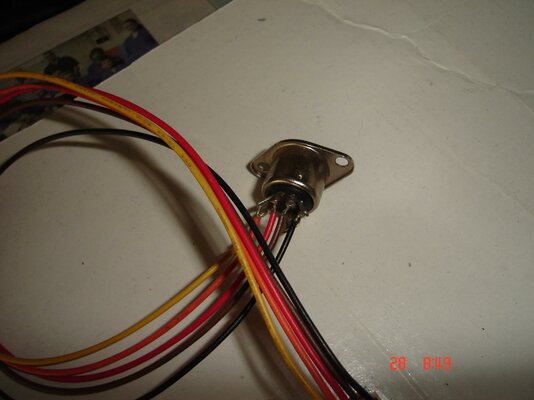

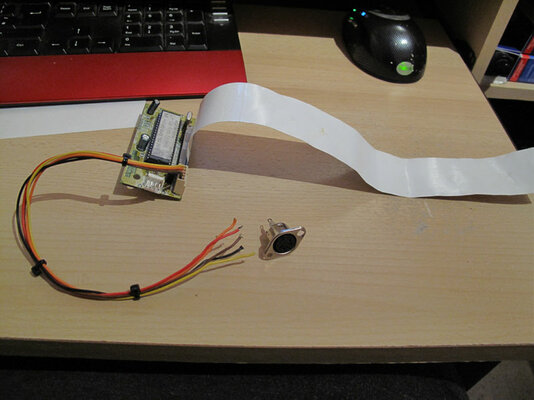

Hi All,
I have an eyetech A1200 keyboard interface which I know works, but due to being knocked around in the tool box has recieved some damage.
The wires that connect to the back of the din plug have broken away.
What I would like to ask is if anyone has one of these interfaces in their machine would you be willing to snap a photo of the back of the din plug so that I can resolder the cables on. Ok I know that the keyboard interfaces are only £20-£30 but to be honest I don't have that kind of money at the moment.
I can't sell the miggy due to the wieght for postage so I might as well get her up and running.
Many thanks in advance for your help,
regards
Bugg

I have many of these devices - if you take a picture of the product you have I can inform you what you need to do to repair it =)
you can upload to your album here or www.postimage.org is a free alternative I would recommend.
Is there noone that has one of these? I felt sure that one amongst us would have one :( wah :cry:

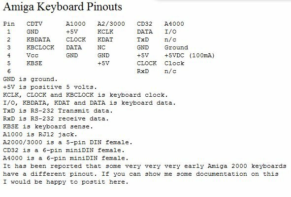

I haven't seen any of these because i didn't own ever an amiga.
But seems easy though.
If i assume that in the female din we plug is an AT keyboard then:
The pinout of AT keyboard is this:
Uploaded with ImageShack.us
So you have to find your female din pinout first
(which goes where). Here then is your female din:
Next step is to allocate the power and gnd cables.
You'll need a multimeter. I don't know the adapter colour code.
So you have to use the multimeter.But first check if under
the adapter (the solder side) is written what you want,
or on the top (parts side) where the cables coming from.
You'll need the +5V.
At a normal pc molex the +5V is the RED color cable.
The GND is the BLACK color cable.
But i don't know who made this and what colorisation
used (maybe he used other colors for no modification)
for example maybe he didn't want someone to modify so
as to use a 9din or 6din instead of the 5din.
For now we have:
RED probably the +5V cable.
BLACK probably the GND cable.
To check with multimeter you have to power
supply the adapter.As i see it needs a mini molex.
So maybe from internal A1200 psu to floppy?
to allocate the +5V. When you do i'll give more
assistance.
But first you have to allocate the +5V and then
do logic with 9 compination for finding the other 3 pins needed.
Check with multimeter (black cable from multimeter always to black,
red cable of multimeter to other cables each measure and write what Volts you get from any color).

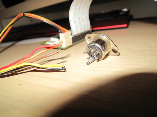

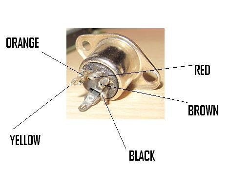

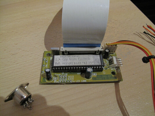

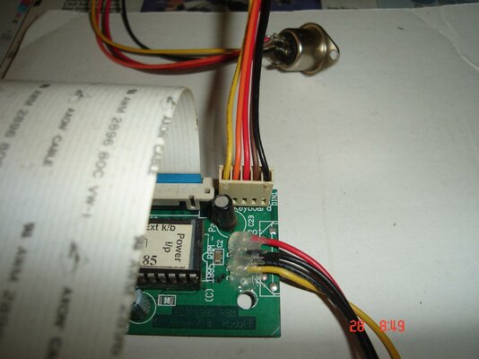

My test board has one of these connected so I have taken a couple of pictures of the wiring and used your picture of the bare connector to point out where each wire goes.
Hope this helps :thumbsup:

Many thanks to all of you for your help...... I will attempt the repair over the weekend and if all goes well i will post Pictures of the miggy springing to life :)
thanks once again.
regards
Bugg
