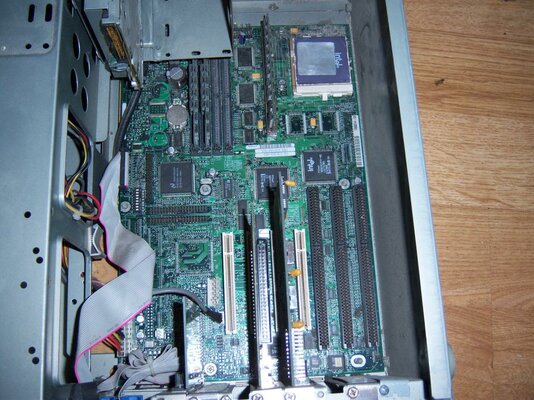

Ok..
so decided to clean out the attic..
Many an old pc and monitor have gone to recycling :picard
I kept this 1 back because i dont know what it is..
so little help with the id please.. "has a socket 5"
a really fast id would help otherwize the wife will make me throw this out too.:help:

well its just a Pentium Pro / Pentium II (possibly around the 233MMX ) motherboard with 512K Cache RAM, 72PIN sockets *I suspect upto 128MB of RAM 32*4, it also has a SCSI card and another PCI card fitted that I cannot see.
I suspect the board might have on board VGA graphics but I cannot identify what or what chipset it might be - the era of the board negates an Intel Video Graphics card. -
socket 5 weren't MMX ;)
only went to 133Mhz too apparently.
so its not a 233MMX, and the Pentium pro used a different socket.
like I said, its landfill :p
One card seems to have a IDE connection onthe top of it and then a funny looking port that looks a bit like ltp on the back "has a scsi sticker"..
then theres an s3 Gfx card near that.
and the small one is a... Unbranded game controller sound card
so its ok to recycle this correct??
its not some one off ancient proto type crazy stupid thing correct
the cpu jumper selections allow upi to 100Mhz says the board.
but then again theres a whole bunch more jumpers than that and im sure if i look there will be a secondary cpu speed selection multiplier..
Sadly its a common bit of kit
(i missed the point where you said Socket 5 LOL)
hmmm Virge S3 graphics eh missed that too.... looks like I am getting old.
I would recyle as much as I could - CPU / Cache RAM / Memory / PCI Cards - if I needed them I would desolder the sockets ISA / PCI - possibly any of the needed chips on the board - FDC etc...
it all depends on what you could re-use from the machine - personally I dont like throwing things away if they can be re-purposed / reused.
its a SCSI PCI controller, the "IDE connection" is actually 50pin, IDE is 40, that was already identified, and is probably worth removing and keeping, may come in handy if you have an amiga with a scsi drive that you're trying to get working.
other than that, I don't see much use for the rest (having said that, I saw no use for the Amigas 10 years ago either...)

It may be old but I neve came across any Cache RAM, which is a real boon for the cpu, always wanted some but non ever came my way.
this is a very familar board layout, cant see any extra sockest for video memory so I hope its got the full 1Mb on board, least it got pci slots so it not all bad
Pentium (I) board, perfectly useful in a DOS box, particularly with both ISA and PCI slots...i am amazed anyone would consider this landfill on a site like this....

but why bother with a Pentium 100, when you can get socket 370 boards with ISA and PCI slots, that will support up to ~1200Mhz CPUs?
and chances are most of those have been thrown out too.
because if i am running a DOS box for compatibility with DOS games i dont want CPUs running a bajillion mhz
a P75/P90/P100 is perfect
and that is kind of the point to this hobby.
