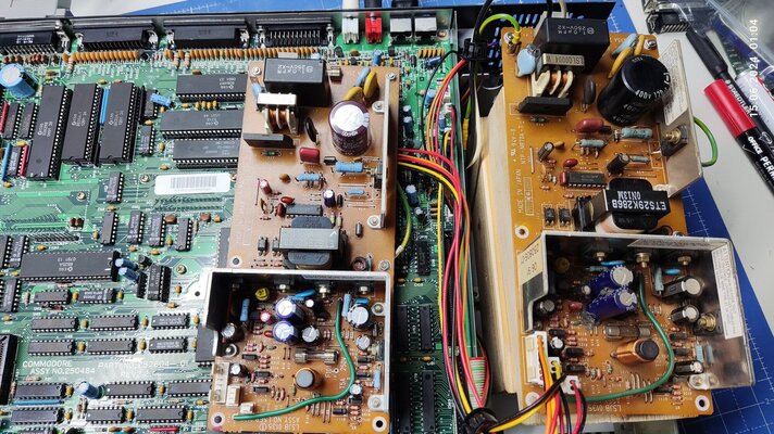

About a month ago, I bought non-working CDTV.
Actually, CDTV are booting fine into CDTV or Floppy menu, but no CD spinning & PSU fan ain't working.
After some restoration (cleaning, rust removal, CD & PSU recap...), I noticed that the power supply still was not working properly.
After that, I did some measurements and found that the +12v and -12v had failed.
+12v has only about +2v
and -12v has +0.5v
By having 2 other working devices, I took out PSU from a working one and tested it at the non properly working CDTV.
With this one, CDTV working as it should. CD booting fine and PSU fan are spinning.
I thought that the (main)coil had something:
Did a swap, but working PSU remain ok
and non-working, with the other know working coil, has still no +12 and -12v.
What else could it be?
Those transistors ie. Schottky diodes?
From left to right:
C3852,
MA756,
K1257,
MA649 and one more
C3852
I've already done a bit of research. But all of them can't be (MA756) or are hard to find.
Some on Aliexpress - but have to wait about 2 months and what quality
Are there (Mouser, Reichelt, Conrad) new comparable models that I can use?
Could be they a problem anyway? Or is there something else dead?
Didn't want to swap them one by one, from a good one. Like that Coil. But if there is no other way, I'm gonna do that too.
Any help will be appreciated.
Thanks for your time.
