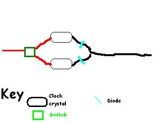

just wondering if i could make a small pcb with 2 clock crystals on it and a switch. (1 crystal is about 33-50% faster than the other)
Or is theiere a "you cant be serious can you" situation i dont know about here?
Here is my really bad scematic :D

If they're linked to a CPU you may also need a halt switch but I've been wondering the same thing regarding the CIC on N64 Everdrives.
What are diodes for? Switch has to be on output so one crystal is completely separated from second one and it should work :).
The outputs merge to 1 point so i dont want the feed going back up through the crystal backwards..
So diodes to stop that. and i put the switch on the input so no feed atall to 1 crystal unless its switched on..

Problem there, clock output is AC, so you'll end up half-way recitfying the output. A better idea might be switched at the input and a bandpass filter on the outputs.
The best way would be to use the switch on the output. Diodes will never give you complete separation. Crystal does not take a lot of power so unused one can still be on :).
for a brute force approach bebeks is certainly the implementation I would chose - having more time I would use a divisor and some jumpers.
Simply put both clocks with +5 / Ground and the output clock attach to a bipol switch - remember to keep wire lenfths short - and in this instance I would humbly suggest 28 - 30 AWG wire for the clock line.

So general thoughts are..
constant live supplied to both crystals. then a switch on the output going back to the board,
both crystals are always live and the switch dictates which gets used, This way both crystals are seperated from eachother and i dont need to worry about diodes...
Correct?
would i need to wire a cap or 2 inline for each clock to make sure there is no V droop..
or will they work as is.
hmmm you may have problems with your implementation - especially if you are looking to feed a Front Side Bus, with Oscilators - everything thing you put in its path distorts the TICK - the worst to include is a jumper / switch, the second is any length of wire.
still its worth having a crack at - just remember it may not work simply because you would need another design approach.
the above description is apt enough to make a simple circuit - perhaps a 10pf capacitor for the feed of the clocks would also help - thats to say the output has a 10pf capacitor to the switch.
sounds like a cap should help then. any way thnx for the input. has ben pretty helpful, and i guess il find out if it works the old fashioned way lol.
