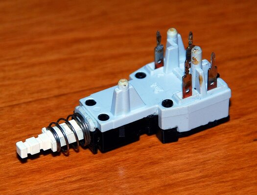

Hi All. I have just received a nice Commodore 1084S-D1 Monitor. Which I'll be doing a re-cap. However. I have notice that the AC switch is sticking, and since it's soldered to the board I can't use another type. I can't find a new switch anywhere. Anyone have one for sale Please...
Thanks..

I dont have a switch but you may not need one.
I had the same problem with the switch in my 1084 d2.
I noticed there was a small hole on the side of the switch so put a drop of 3 in 1 oil in the hole.
The switch as worked smoothly since.
