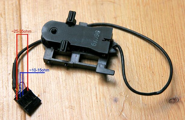

Hi,
I'm looking for commodore 1541 drive head(s). Got two drives, that
both have bad head (resistance 15 kilo-ohms, when it should be <100ohms).
Exilent seem to have sold these recently; if you still got 'em, I'm raising
interest and asking kindly to PM me. I'd PM you directly, but it's not possible, since this is my very first post here and PM rights needs a couple of posts first :).
Goods arrived yesterday.
Already switched newtronics head to faulty drive and got
it working!
Thanks a lot :)
