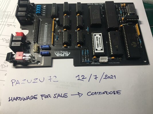

The marked "74LS14" are C-Mos clones, into the not powered "LS" ics the inputs result electrically insulated,
but the C-Mos input pins have ESD protection diodes that "clamp" the pin to Vcc line, so if Vcc become zero the input pin will force the line to zero, imagine this on serial lines, or on reset lines (the vic20 will be reset)
No.
Chinese fake/rebranded chips are CMOS clones. Genuine 74LS chips purchased from authorized distributors use BJTs - NOT CMOS - and accordingly consume more power. They also all have pull-up resistors in all inputs.
If you buy all your logic chips from Amazon or eBay from Chinese vendors then you may think all 74LS chips are CMOS clones. real ones are NOT.

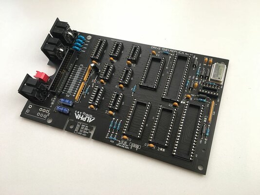

1581 replica boards received, thank you. International shipping was pleasantly fast with respect to how packages are moving lately.
One note though, the 74LS14 provided was marginal, had to replace to allow correct operation > issue was 74LS14 gate locking up IEC bus when drive not powered up but still connected to IEC bus.

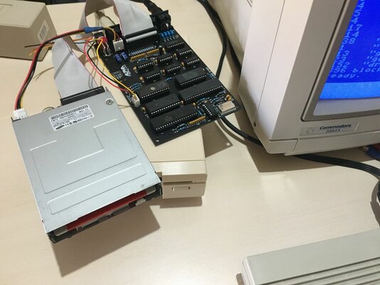

Prototype of my smd version of the 1581 board (size 100 x 80 mm). Allows you to connect both a standard and a slim drive.
It seems to work correctly. I'll do a post sale when I'm done. Maybe someone is interested in some project.
