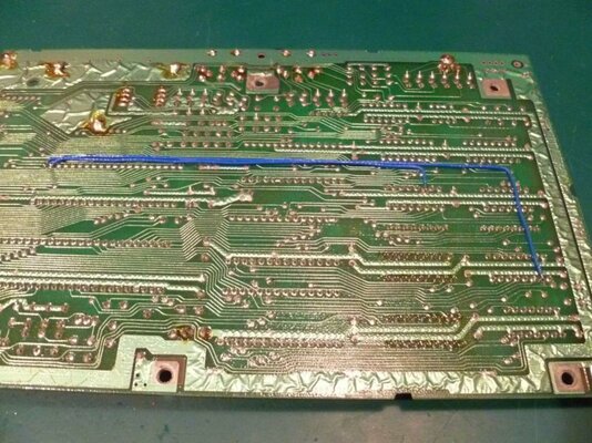

Cercamon sent me his C16 this week and tonight I had a few minutes free, so without the use of any cats (I find they don't get hot enough to solder with) I converted and tested the board. Here's some pics for your viewing pleasure:

Package with the expanded board just delivered into my hands. Will try it soon.
Thanks to @Bryce for his handiwork and overall kindness.
