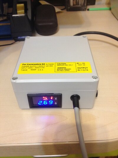

Power supply for C64, this is new one built by me, tested thoroughly with the two C64 I have, a 64C and a bread bin.
Model K644-D 1 available Price 60€ + Shipping cost, if anyone is interested I could manufacture some more but need some time (4-8 weeks), the price is 60 € or 55 € without the digital display.
Advertised elsewhere.
I want to clarify that although they have protection against overvoltage, it acts on 5.75 ~ 6.75V so it could affect some component of the C64, I have tried them intensely and I have had no problem.
Payment with Paypal friends&familly.
Shipping by registered mail is 16€ for Europe and 24€ for the rest of the world.
For some countries it can be shipped by mondial relay at cheaper price.
Power Supply K644-D for Commodore 64
Input 220VAC , output 5,1-5,2 VDC @ 2.7A and 9VAC @ 1A
AC input IEC-C14 socket protected with 500mA slow fuse. Suitable for most countries using appropriate IEC –C13 Power Cord.
MEAN WELL RS-15-5; 15w; 5VDC; 3A switched-mode power supply for 5VDC line with overvoltage, short circuit, temperature and overcurrent protection.
12VA (9v 1,33A) Transformer for 9V AC line protected with 1A fuse.
Power ON/OFF switch, led indicator for 9V , Dual Digital Voltmeter Amperemeter.
Dimensions: 115x125x56mm. Output cable length approx. 1m. with 7 pin DIN connector.
Tested 30´ at maximum load and 6 hours at 80% load. 5 Volts DC line adjusted to 5,1-5,2 Volts to compensate for cable&C64 voltage drop. Tested 1 week (2h/day with a real C64)
