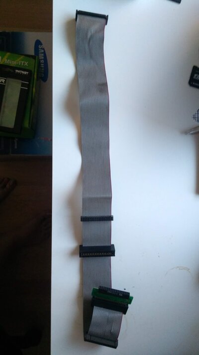

To use the internal Amiga floppy drive, you have to install the so called shared floppy cable connecting the Amiga floppy controller with the bridgeboard and the bridgeboard with the floppy! Without this cable, you have to connect a PC floppy drive to the floppy ort of the A2386...

I didn't know that about shared floppy. I got this cable, can it be used?
This is a standard floppy cable!
Regarding this cable, can somebody post a picture of it? Should be easy to build (I'd like to have one), but I'd like to see what the original looked like and how long it was.
