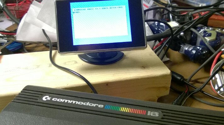

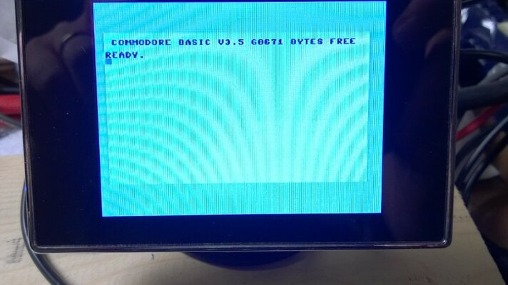

Since everyone is showing off pictures. Say hello to my little friend. 64K and JiffyDos.
I used the guide here this week as well.
Here is another guide that I first used:
http://c128.com/comment/667#comment-667
I had problems with this guide and ended up going back to the one here but I believe failed to cut the trace on both lines as needed.
On my motherboard I could not see the line that needed to be cut on the top of the motherboard (74SL257) and ended up doing the wrong one. I ended up removing the IC and repaired the line from the bottom of the board.
If I had to do it over again I would go back to Callan's guide as it would be much easier to cut the 2 traces on the bottom of the board.
