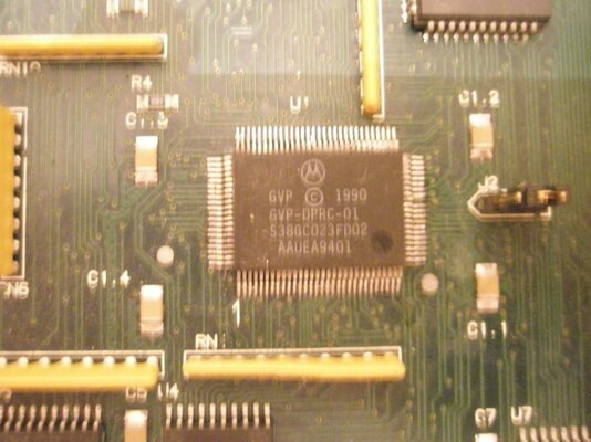

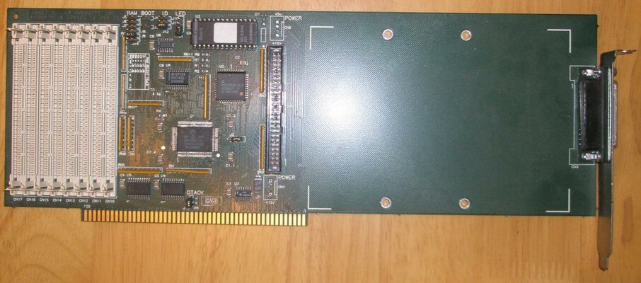

Piccys as requested.
If you look through the blurred image at the chip near J2 - this has a broken track to the chip. It has also been off at some time and refitted. There are a few shorts on the soldering - which is why it was shoved in my box as a "I'll sort it out one day job".
Also one of the clips on the RAM sockets is broken.
Dave G :cool:

I bathed the SCSI chip in SMD flux, resoldered the pins and wire-patched the main damaged pin. I also found two pins shorted on the chip --I carefully bent them back perfectly. Lateron I glued back on the broken SIMM clip.
It works great, I even burnt out the latest official ROM on an EEPROM for it.
