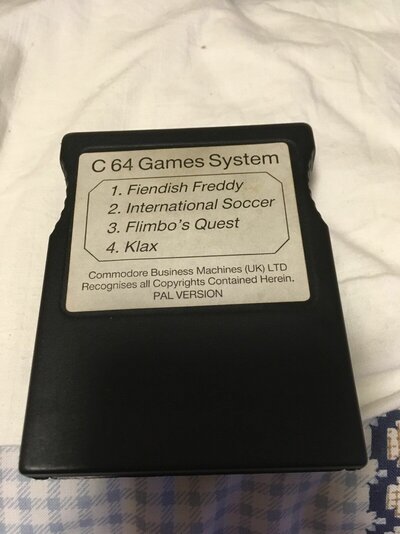

You told by PM that the cartridge was included, but you send me a wrong cartridge not valid for MAX.

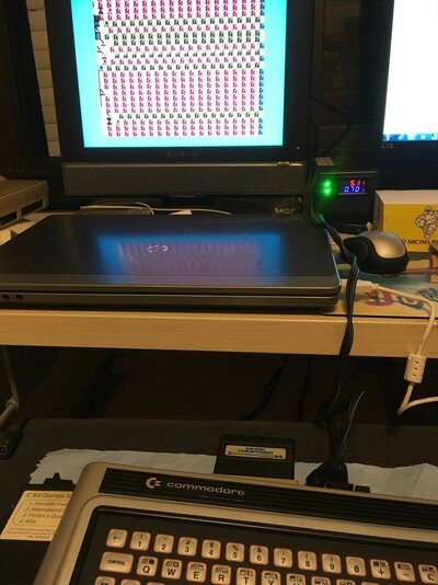

I made the composite video mod to be able to test the computer, following this info: http://www.6502.org/users/sjgray/projects/maxvid/index.html
In this web mention that Music Maker / Music Composer cartridges work with MAX computer, I have one from C64, so I plugged it and I only can see garbage in the screen, but presing a key I can hear the music playing, in the pictures of the web I can see a C64 MUSIC MACHINE working, so I think there is some problem with the MAX.

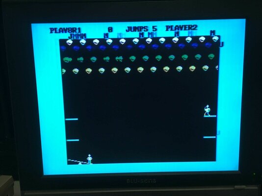

Also tested with a Versacart, following this: https://retrofixer.it/en/max-machine-composite-mod/
Burning a ROM with MAX games, and I can see the start screen of the games, but then the graphics are corrupted. I don't know if this is normal.
If anyone with a working MAX could confirm this it will be very helpful.

MAX is working!!!
A jumper between pins 9&10 is needed in the cartridge to work with MAX.
