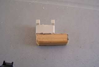

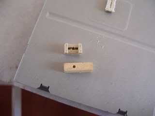

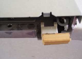

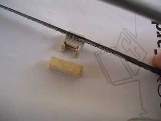

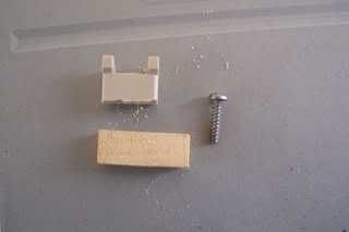

The whole kit is on the east coast USA with my brother right now, so can't do any measurements. But I the dying OEM drive I took out was the FB-354 by Chinon. It from an A500 Rev6a.
rkauer said:
A good advice is to locate ancient 32mm drives, as they fit perfectly on the height. The eject button can be relocated if needed.
I never see a 32mm drive that cannot be hacked to work on the Amiga, BTW.
Feels like my 2 best options are either adjust the height of a PC drive and mod the eject button, or try to find a 32mm floppy. If you don't mind cutting up your A500 case a bit, check out the solution for relocating the eject button here:
http://eab.abime.net/showthread.php?p=709133#post709133
